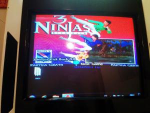

alex2005 Posted March 16, 2015 Posted March 16, 2015 Hello guys, Hope you can help me on that; the situation is, I normally start Windows and Hyperspin at 640x480. But then I would like to switch to lower resolution to play certain emulators without interlacing (ie zsnes, kfusion). I think this should be pretty easy to achieve, however I am running on issues: > I call to 640x288.exe before running the emulator, and after exiting, I call 640x480.exe The emulator starts perfectly, switches to resolution as expected, however when I exit the emulator in Hyperspin, it does not gracefully exit back to 640x480. Instead, I get a sort of split screen (see screenshot), HS does not go back to full screen at 640x480. Could someone please give me a hand on this? I would like to exit the emulator normally and return back to HS at 640x480. Screenshot: My current code is something like this: ;---------------------------------------------------------------------------- ; Super Nintendo ; Znesw 1.51 ; by Shateredsoul ; 1.1 ; ;Info: ; ;Make sure you set quickexit to your escape key while in ZSNES. ;If you want to use Esc as your quick exit key, open zsnesw.cfg ;with a text editor and find the lines below. Set KeyQuickExit ;to 1, as shown below. You can't set the quick exit key to ;escape while in the emulator, because that's the exit key to ;configuring keys. ; ;Quit ZSNES / Load Menu / Reset Game / Panic Key ;KeyQuickExit=1 ;KeyQuickLoad=0 ;KeyQuickRst=0 ;KeyResetAll=42 ; ;---------------------------------------------------------------------------- Run, D:\utilidades emuladores\Switchres\640x288.exe Run, %Executable% "%romPath%%romName%%romExtension%", %EmuPath%, Process, WaitClose, %executable% sleep, 3000 Process, Close, Hypersplash.exe ExitApp CloseProcess: Process,Close,%executable% Run, D:\utilidades emuladores\Switchres\640x480.exe return I would really appreciate any hints on this. Btw, I use an ArcadeVGA 5000, and Windows 7 64 bits, in case that helps. All other emus (GroovyMAME, Model 2, etc) do work well switching resolutions. Its just this exit behavoir that makes me crazy at the moment Thanks a lot!

alex2005 Posted March 17, 2015 Author Posted March 17, 2015 Yes, i can switch resolutions in windows with no problem. I tried with your suggestions a while ago with the same result. What I see is: 1- when launching the snes game, I can see HS frontend switching to 640x288, and then the emulator starts at 320x240 with the game loaded. 2- when I exit, the desktop is set at 640x480, however the hyperspin frontend remains by some reason at 640x288 with the screen halved. So actually the resolution is changed, just wondering why the HS frontend does not resize correctly, when it actually should. I will give it a try with qres, but from what i see it is an old tool, not sure if it will work on W7

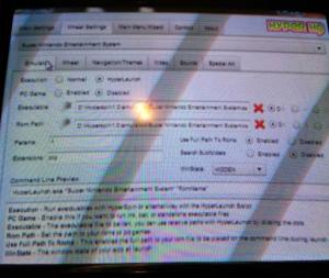

alex2005 Posted March 17, 2015 Author Posted March 17, 2015 hmmm.... I can't see the option on the specific emulator, also it doesnt show in the main settings of HyperHQ... I can run the emulator at 640x480 interlaced, but would prefer to set up zsnes and kfusion at a low res, which looks 100 times better than interlaced

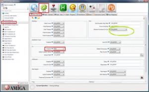

Dime333 Posted March 17, 2015 Posted March 17, 2015 hmmm.... I can't see the option on the specific emulator, also it doesnt show in the main settings of HyperHQ... [ATTACH=CONFIG]52183[/ATTACH] I can run the emulator at 640x480 interlaced, but would prefer to set up zsnes and kfusion at a low res, which looks 100 times better than interlaced That is HyperHQ. That's where you change settings for Hyperspin. Are you not using Hyperlaunch? If so, you can change settings for that with HyperlaunchHQ. I grabbed a random image of the internet and higlighted the setting in green.
alex2005 Posted March 17, 2015 Author Posted March 17, 2015 thanks for the details! I use hyperlaunch, but not hyperlaunchHQ It may work actually... can I just download HyperlaunchHQ and run it, or will it modify many things from my current setup? I am afraid to screw my current setup trying, but if its something that will not touch many settings, I will give it a try

Dime333 Posted March 18, 2015 Posted March 18, 2015 Thanks! Really glad to know this has a solution I tried updating via GIT in the past, and my experience was a bit frustrating. By some reason it updated to a beta version and I read later on that it was not compatible with my current setup. Will it help if I just download HyperLaunchHQ (I think I got the install bits of version 1.0.13 somewhere)? I do use GroovyMAME, which works great on Windows 7 with ArcadeVGA, and I no longer have the famous "directdraw" error when switching resolutions. Works like charm really I will be switching to GroovyUME at some point, since I have a lot of computer systems which I want to emulate, and seems the simplest way to go If changing this setting is all that you need to do, you can just go to HyperLaunch\Settings\Super Nintendo Entertainment System\ and edit the file "hyperlaunch.ini" Under the section called [exit], there should be a line that says "Restore_Front_End_On_Exit=use_global". Change that line to "Restore_Front_End_On_Exit=Restore and Click" or "Restore_Front_End_On_Exit=Restore". It sounds like you have an outdated version of Hyperlaunch, so I can't say for sure that you have this option. But give it a try.
