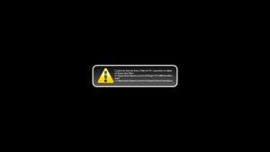

squirl Posted March 19, 2015 Posted March 19, 2015 I am a new member to this forum. For the past few weeks I have been gathering much information on getting my Hyperspin system setup. This forum as well as the video tutorials that members have posted have been indispensable. But I have hit a road block that has me running in circles. Steam setup. Installed programs Hyperspin 1.3.3.0 Hyperlaunch v3.1.0.5 BETA Hypertools 4.3.25 Steam Wheel Creator I am trying to get Pac-Man Championship Edition DX+ running on Hyperspin. I used the Steam wheel Creator and I have the wheel and artwork installed. Problems HyperlaunchHQ - When audit games, Pac-Man Championship Edition DX+ is displayed in pink showing not found. If I try to run Pac-Man Championship Edition DX+ I get this error. It is probably a simple fix, but I was hoping somebody had an idea.

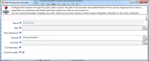

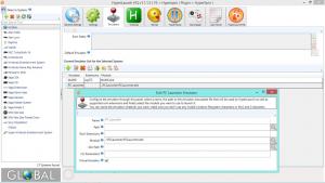

gigapig Posted March 19, 2015 Posted March 19, 2015 Hi Squirl, welcome to the forum. Steam games will show up as pink as there is nothing for HyperLaunch to look for against what's in the XML. Unlike most other systems that have Rom files with and extension to look for. As for your problem, did you set up PCLauncher under Global emulators like the picture below? There are also some issues with Steam Wheel creator.
squirl Posted March 19, 2015 Author Posted March 19, 2015 Thanks for the reply GigaPig. I followed your video tutorial and believe I set the parameters properly. I don't think I have the emulator path set properly. Should I be having Hyperspin point to the Steam.exe file in a .ini?
gigapig Posted March 19, 2015 Posted March 19, 2015 If this is new to you then you may need to go into the module folder and find the file "PCLauncher (Example).ini" If you don't also have a PCLauncher.ini you need to do this. Make a copy of the file PCLauncher (Example).ini, then rename the original removing the "Example" so it reads "PCLauncher.ini" Also I notice you have capitalised the system name "STEAM", you need to be careful and name things Exactly, so Steam should be Steam, it's the reason the icon isn't showing. A good thing to do if your unsure is to go to the :hyperSpin\\HyperLaunch\HyperLaunchHQ\Media\Icons and look at the way the icons are named.
squirl Posted March 20, 2015 Author Posted March 20, 2015 Thanks gigapig! I used the name "PC Launcher" instead of "PCLauncher" Name change makes Steam go from not working to working.

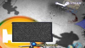

squirl Posted March 20, 2015 Author Posted March 20, 2015 Steam works great using Hyperspin. I just installed Robot Roller-Derby Disco Dodgeball as well. Still working on getting the video to display in preview of game. The audio works, but no video in Steam wheel preview. This is what I changed. C:\Hyperspin\Hyperlaunch\Settings\Steam\Emulators.ini [ROMS] Default_Emulator=PCLauncher Rom_Path= [PCLauncher] Emu_Path= Rom_Extension= Module=PCLauncher.ahk HyperPause_Save_State_Keys= HyperPause_Load_State_Keys=
