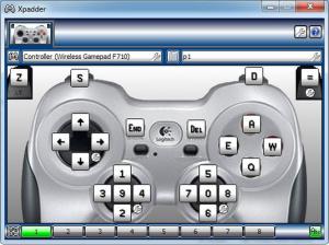

Ibanezmike Posted April 1, 2015 Author Posted April 1, 2015 I have two Xpadder profiles in HyperlaunchHQ, "HyperSpin" and "_Default". Both point to the same Xpadder setup and looks as follows: I then went into all the emulators and mapped the controller input options to those keys. The reason I done it this way is because those keys are the ones mapped to my control panel joystick and buttons, more or less. I would like to be able to use the control panel on my arcade machine and/or the controller.
