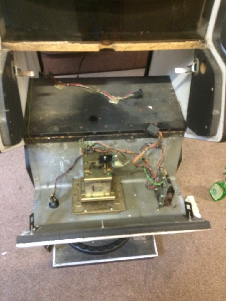

Well I was not as happy with this purchase.
I made a purchase in the dark and bought it with out seeing it working and without getting a proper look at it
In the daytime and I can now see the cab is in poor condition and a few things not working.
I must mention these old cabs don't like to be moved,So I wasn't shocked to see a rom error or the monitor colour problem.
After cleaning it for a few hours I kept finding dirty parts every where it was so grimy
And the inside is showing age the power supply needs a good clean and the wiring loom has more joints than Jamaicans cigarette tin.
But that's a easy fix with a bit of love I could get her back to near new

The guy also told me the accelerate pedal was stuck on so when you fired up the game it was go go go .
After 1 hour trying to get this bolt out I found out why the pedal was on full this cog had come loose and of course nobody had put the work in to get the Into pedal enclosure
