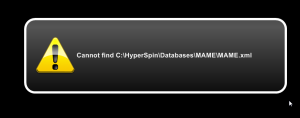

CroCop Posted April 16, 2015 Posted April 16, 2015 Hello, everytime i want to start MAME i get this error: Cannot find C:\_HyperSpin\Databases\MAME\MAME.xml I dont know why its Pointing to C: , i have installed everything in G: like this "G:\_Hyperspin" and here is where my xml are stored G:\Hyperspin\Databases\MAME Do you have any idea what could be wrong with my setup or how to point it to the right Databases?
gigapig Posted April 16, 2015 Posted April 16, 2015 Welcome to the forum Crocop. That does sound strange, is it HyperSpin or HyperLaunch throwing up that error? Post your HyperSpin log. The only other thing I can think of is the naming of the system or if it's on an external drive.
CroCop Posted April 16, 2015 Author Posted April 16, 2015 Thank you im getting this error in Hyperspin, i have attached it. i hope this is the right log you are looking for: 05:58:01 PM | HyperSpin Started 05:58:01 PM | Going FullScreen 05:58:01 PM | Checking for updates 05:58:01 PM | Update Check Complete 05:58:01 PM | Startup program: HyperSpin Startup Script.exe 05:58:01 PM | Startup params not set 05:58:01 PM | Working directory: G:\_Hyperspin\Programme\HyperSpin Startup Script\ 05:58:01 PM | Window State: NORMAL 05:58:01 PM | Launching HyperSpin Startup Script.exe 05:58:01 PM | Command Line is HyperSpin Startup Script.exe 05:58:01 PM | Error intializing joysticks 05:58:01 PM | Menu Mode is multi 05:58:01 PM | Loading Main Menu.xml 05:58:01 PM | Main Menu.xml successfully loaded 05:58:02 PM | Main Menu wheel loaded successfully 05:58:11 PM | Loading MAME.xml 05:58:12 PM | roms_only is true, checking files 05:58:14 PM | Main Menu.xml successfully loaded 05:58:14 PM | MAME wheel loaded successfully 05:58:19 PM | Launching Game 05:58:19 PM | Using HyperLaunch 05:58:19 PM | Getting HyperLaunch path 05:58:19 PM | HyperLaunch located at G:\_Hyperspin\HyperLaunch.exe 05:58:19 PM | Running HyperLaunch.exe 05:58:19 PM | HyperLaunch Command Line is: G:\_Hyperspin\HyperLaunch.exe "MAME" "zintrckb" 05:58:23 PM | Loading Main Menu.xml 05:58:23 PM | Main Menu.xml successfully loaded 05:58:24 PM | Main Menu wheel loaded successfully 05:58:25 PM | Exit program unavailable 05:58:25 PM | Quiting Hyperspin 05:58:25 PM | Bye! And this is how my folder looks like: I tried to follow this tutorial
esoteric Posted April 16, 2015 Posted April 16, 2015 I'm not sure how to tell Hyperlaunch to look in a different location for the xml files (the default is the C drive and that's why you're having the issue.) What you can do though is just create a C:\_HyperSpin\Databases\MAME folder on your C drive and put the xml in there. It sucks that its a file you don't want on your C drive, but it shouldn't take up much room to just have the xmls on your C drive until you can find a permanent solution. http://www.reddit.com/r/HyperSpin/

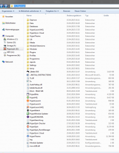

gigapig Posted April 16, 2015 Posted April 16, 2015 Strange that you have an underscore in the path (G:\_Hyperspin\Programme\HyperSpin Startup Script\) not seen that before. The error is from HyperLaunch not HyperSpin. HyperSpin is also using a version of HyperLaunch located in the root folder of HyperSpin, which is not good. If your using RocketLaunch it should be in a separate folder. Have a look at this http://www.hyperspin-fe.com/topic/7625-hyperspin-1330-new-user-guide/ Really you should ask Austin, either here or on his Youtube channel. Edit:Just looked at your folder, did Austins guide say to place HyperLaunch there?? HyperLaunch and Hyperspin both have media folders so putting them together is bad. You may need to start again.
CroCop Posted April 16, 2015 Author Posted April 16, 2015 Hmm im not sure if he said that. I will start over again
gigapig Posted April 16, 2015 Posted April 16, 2015 You have a HyperLaunch HQ folder but no HyperLaunch folder. The HyperLaunch HQ folder is normally located inside the HyperLaunch folder.
CroCop Posted April 16, 2015 Author Posted April 16, 2015 Ok now im confused. In Austins video he do not have a HyperLaunch folder too. Can you give me a link to an guide u would normaly use?
gigapig Posted April 16, 2015 Posted April 16, 2015 Ok now im confused. In Austins video he do not have a HyperLaunch folder too. Can you give me a link to an guide u would normaly use? OK, I had to go a watch his guide or up to around 11 minutes in. What he has done is wrong by dragging the entire contents of the zip into the HyperSpin folder. As you can see from the video he overwrites the Media folder, so putting Hyperlaunch media in the Hyperspin Media folder. That may still work to a degree but the folders will be a confused mess, I'm surprised no one mentioned it in his comments. What should have happened is when he opened the zip he should have picked up the HyperLaunch folder and dropped that in, or created a HyperLaunch folder and copied the contents across. It's also not updating HyperSpin it's just mixing HyperLaunch and HyperSpin, two very separate programs. Here's a written guide http://www.hyperspin-fe.com/topic/2187-how-to-install-hyperspin/ I also do video guides and they can be found in my signature, but you should mention this to Austin.
