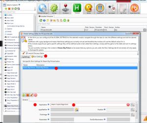

gigapig Posted April 21, 2015 Posted April 21, 2015 I have successfully managed to do what you want but it will go to the sub wheel. So first in HyperHQ I created the wheel called Steam Big Picture and said it had a sub wheel. Next I created a database for that new system with only 1 entry in it and that was again SBP <menu> <header> <listname>txt</listname> <listversion /> <lastlistupdate>1/6/2014</lastlistupdate> <exporterversion>HyperTools 4.3.25</exporterversion> </header> <game name="Steam Big Picture" index="" image=""> <description>Steam Big Picture</description> <cloneof /> <manufacturer /> <crc /> <genre /> <year /> <rating /> <enabled>Yes</enabled> </game> </menu> Now I fired up HyperLaunch HQ and had the new entry in the left pane. Highlight it and click the emulator tab, then choose the default emulator which will be PCLauncher, Hopefully you already have that set up under Global, if not go there and check the Virtual Emulators box, that's all. Lastly go back to the system and now choose the Modules tab, highlight PCLauncher and click on the "Edit Global Module Settings" box Now if all is well you should see this when you click on the Rom Settings tab. If you see that code in the applications box then it should launch straight into SBP, there is no need to do anything else. I hope that helps.
Nano Posted April 22, 2015 Author Posted April 22, 2015 First of all Gigz, thank you very much. This did not exactly work but it did put me on the right path to getting it working. First of all the PCLauncher did not appear as a selectable emulator (even after selecting virtual emulator) and module until I opened the Hyperlaunch\Modules\PCLauncher\PCLauncher.ahk and changed: MSystem = "Games for Windows","Microsoft Windows","PCLauncher","PC Games","Taito Type X","Touhou" to MSystem = "Games for Windows","Microsoft Windows","PCLauncher","PC Games","Taito Type X","Touhou","Steam Big Picture" Then restarted HyperlaunchHQ and it was selectable on the left pane under Steam Big Picture. After that, I followed your instructions and I couldn't do it as easily as I thought. For the edit global settings button I recalled in your video you must expand the window to show the +/x delete buttons to add Steam (that confused me at first). But that worked. I had to add "Steam Big Picture" then add the path to Steam. So my screen looked a bit different to yours but it seems to work. In Steam's options I set it to always launch in Big Picture mode, I guess that helped. Thanks again!
