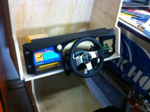

Xx_Strike_xX Posted February 11, 2013 Posted February 11, 2013 Thats what this guy did. I have msged him with no luck. I was thinking about doing something like this [sIGPIC][/sIGPIC]
Fursphere Posted February 11, 2013 Author Posted February 11, 2013 Don't you lose the buttons when you do that? And the G27 has a board directly under the center steering wheel cap for the on "on wheel" LED tachometer (which is of questionable use to begin with...). Then directly behind that it has the paddle shifter assembly. I didn't dig any deeper than that. I'm sure its possible, I just don't think its worth destroying my warranty. The way I'm thinking about mounting it should be rather universal - so if I have to change wheels in the future for whatever reason, mounting the new one shouldn't be an issue. I try to do as much "forward thinking" as possible when I build things...

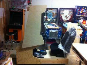

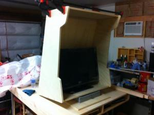

Fursphere Posted February 11, 2013 Author Posted February 11, 2013 Quick side profile shot.... Garage is a mess, but that's what happens when its your game room / hobby room / work-in-progress project room.

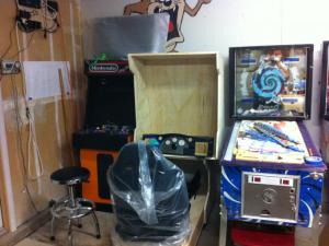

Fursphere Posted February 13, 2013 Author Posted February 13, 2013 Set the upper cabinet on top of the lower this morning before work. Its bigger than I imaged it would be. 68.5" tall at its highest point. It comes out from the wall pretty far too - I'll probably have to re-arrange some of the other games to make them fit a bit more comfortably.

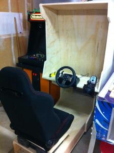

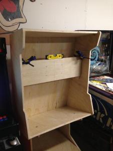

Fursphere Posted February 16, 2013 Author Posted February 16, 2013 The upper cabinet is officially bolted down to the lower cabinet as of tonight. I did some more test fitting of the steering where and shift. I basically set a board up there, leveled it out, and mounted the wheel and shifter, with the clamps from the wheel butting up against the board beneath the mounting board. The shifter feels like it needs to be about four more inches out (towards the seat). I started taking the dashboard apart too, so I can hack on it. Also, with the seat raised 5" from the base, my eyesight is dead center on where the center of the screen will be, so that worked out perfectly. I should be ready to start working on the screen mount as well.

Fursphere Posted February 17, 2013 Author Posted February 17, 2013 So my first attempt at modding the dashboard didn't go so well. I got the shape of the G27 housing mostly right, but I measure from the bottom wrong - so there is a huge gap able the G27 housing. Its not a big deal though, since I had a contingency plan before I even started cutting - just incase something like this happened. I don't want to track down and hack up another dashboard.

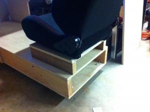

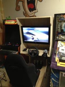

Fursphere Posted February 17, 2013 Author Posted February 17, 2013 Quick update. Finished hacking on the dashboard for now. I'll create a custom insert for it later to fill the gap. Aluminum or carbon fiber or something. Built the stand for the seat. Its not finished yet by any means, but the height feels right. The 2x4 and 2x6 - I've been thinking that I'll "skin" then with thin aluminum or something to cover up the "home depot" look down the road. And finally hooked up the TV to see how the distance feels. Needs to move back a bit (and up!). Awesome picture quality though - no complaints here. I have tomorrow off so hopefully I'll be able to get the screen mounted.

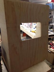

Fursphere Posted February 19, 2013 Author Posted February 19, 2013 Another quick update. Monitor mount has been built, and I cut an access hole in the back of the cab to be able to mount the screen. I'm still not sure on the angle I want the screen. The arcade driving cabinets seen to be at almost 90 degrees (straight up and down). I was playing it that way last night a little (as the screen was setup in the last post) and it seem'd ok, but the screen will be higher than that.. so maybe slightly downward? 10 degress or less?

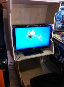

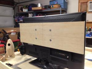

Fursphere Posted February 22, 2013 Author Posted February 22, 2013 Monitor mount almost complete. I glued and screwed the side supports to the inner cabinet walls. Part of me is saying "that's not enough" - I'm not sure if I'll add more or not. Maybe screws from the outside in? Small carriage bolts? Dunno yet. I need to pickup some longer bolts to secure the mounting "plate" to the side supports. I could just screw it in there, but if I ever have to change out the screen - it'll be easier if I have to change the mount at all.
Fursphere Posted February 23, 2013 Author Posted February 23, 2013 Screen mounted. I hooked everything up and actually played a few games of Dirt 3 to get a feel for it. I think I mounted the screen about 2" too high. Not the end of the world - I just might have to make a new mounting plate to lower everything down.
