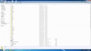

Found it. I think you meant the .cfg file? well i deleted it. ran area 51. it created a new one. I then remapped the controls in the game, "orignally it says mouse 1x/mouse 1y for the axis's before i deleted the file". This time when I did it it sayd gun1 instead of mouse. When I went to go play the crosshair was steady again. So for the crosshair to be steady I believe it needs to register as "gun" and not "mouse" when setting up the axis in the tab menu.

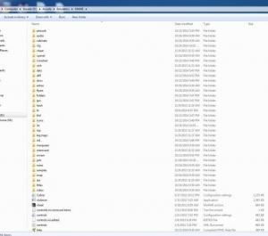

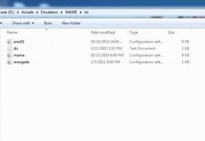

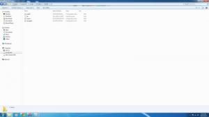

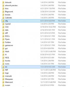

Here is my mame folder. The ini folder. I believe all of these are created by default when you run a mame -cc to do the initial setup. The cfg folder contains the games specific configurations if any. Now I generally attack mame with a 1 size fits all approach so I configured mame to use all 4 of my controllers, both aimtrak guns, and the utrak all in default mame configuration. So automatically most everything just works. Some of analog stick games (AD I think?) (Terminator, Aliens, etc) require the aimtraks and others like Stun Runner require a analog stick or just keys setup in my case I configure those few games that are analog stick games with per game settings under configure controls for this game. So the stuff in your .cfg files should be empty unless you are setting your controls per shooting game in which case you would have a bunch of stuff in those .cfg for anything you setup special for that specific game.
The ini folder has basically a copy of the mame.ini that is renamed to romname.ini This is where I adjust the controller inputs and select offscreen reload 1 for games that use off screen reload or 0 if they do not. With out having these game specific inis I ran into issues with games that were off screen reload and were set to 0 the inputs would not work or both guns would work from 1 gun. Same with games that were not off screen reload and were set to 1. Now because I have a utrak I need the mouse settings at 1 for arkanoid type games and golden tee.

Then in your mame folder. Make a INI folder put a area51.ini in there with this in it:
# CORE CONFIGURATION OPTIONS
readconfig                1
writeconfig               0
# CORE SEARCH PATH OPTIONS
rompath                   H:\Hyperspin_Roms\MAME\Roms
hashpath                  hash
samplepath                samples
artpath                   artwork
ctrlrpath                 ctrlr
inipath                   ini
fontpath                  .
cheatpath                 cheat
crosshairpath             crosshair
highpath                  dats
# CORE OUTPUT DIRECTORY OPTIONS
cfg_directory             cfg
nvram_directory           nvram
memcard_directory         memcard
input_directory           inp
state_directory           sta
snapshot_directory        snap
diff_directory            diff
comment_directory         comments
hiscore_directory         hi
video_directory           video
# CORE STATE/PLAYBACK OPTIONS
state
autosave                  0
playback
record
mngwrite
aviwrite
wavwrite
snapname                  %g/%i
snapsize                  auto
snapview                  internal
statename                 %g
burnin                    0
# CORE PERFORMANCE OPTIONS
autoframeskip             0
frameskip                 0
seconds_to_run            0
throttle                  1
sleep                     1
speed                     1.0
refreshspeed              0
# CORE ROTATION OPTIONS
rotate                    1
ror                       0
rol                       0
autoror                   0
autorol                   0
flipx                     0
flipy                     0
# CORE ARTWORK OPTIONS
artwork_crop              0
use_backdrops             1
use_overlays              1
use_bezels                1
use_cpanels               1
use_marquees              1
# CORE SCREEN OPTIONS
brightness                1.0
contrast                  1.0
gamma                     1.0
pause_brightness          0.65
effect                    none
cleanstretch              0
# CORE VECTOR OPTIONS
antialias                 1
beam                      1.0
flicker                   0
# CORE SOUND OPTIONS
sound                     1
samplerate                48000
samples                   1
volume                    0
soundsync                 0
# CORE INPUT OPTIONS
coin_lockout              1
ctrlr
mouse                     0
joystick                  0
lightgun                  1
multikeyboard             0
multimouse                0
steadykey                 0
ui_active                 0
offscreen_reload          1
joystick_map              auto
joystick_deadzone         0.3
joystick_saturation       0.85
natural                   0
joystick_contradictory    0
coin_impulse              0
# CORE INPUT AUTOMATIC ENABLE OPTIONS
paddle_device             keyboard
adstick_device            keyboard
pedal_device              keyboard
dial_device               keyboard
trackball_device          keyboard
lightgun_device           keyboard
positional_device         keyboard
mouse_device              mouse
# CORE DEBUGGING OPTIONS
log                       0
verbose                   0
update_in_pause           0
debug                     0
debugscript
debug_internal            0
# CORE MISC OPTIONS
drc                       1
drc_use_c                 0
bios
cheat                     0
skip_gameinfo             0
uifont                    default
ramsize
confirm_quit              0
ui_mouse                  0
autoboot_command
autoboot_delay            2
autoboot_script
http                      0
http_port                 8080
http_path                 web
hiscore                   1
# WINDOWS DEBUGGING OPTIONS
oslog                     0
watchdog                  0
debugger_font             "Lucida Console"
debugger_font_size        9
# WINDOWS PERFORMANCE OPTIONS
priority                  0
multithreading            0
numprocessors             auto
profile                   0
bench                     0
# WINDOWS VIDEO OPTIONS
video                     d3d
numscreens                1
window                    0
maximize                  1
keepaspect                1
unevenstretch             1
prescale                  1
waitvsync                 0
syncrefresh               0
menu                      0
# DIRECTDRAW-SPECIFIC OPTIONS
hwstretch                 1
# DIRECT3D-SPECIFIC OPTIONS
filter                    1
# DIRECT3D POST-PROCESSING OPTIONS
hlsl_enable               0
hlslpath                  hlsl
hlsl_prescale_x           0
hlsl_prescale_y           0
hlsl_preset               -1
hlsl_write
hlsl_snap_width           2048
hlsl_snap_height          1536
shadow_mask_alpha         0.0
shadow_mask_x_count       320
shadow_mask_y_count       240
shadow_mask_usize         0.09375
shadow_mask_vsize         0.109375
curvature                 0.03
pincushion                0.03
scanline_alpha            1.0
scanline_size             1.0
scanline_height           1.0
scanline_bright_scale     1.0
scanline_bright_offset    0.0
scanline_jitter           0.0
defocus                   0.0,0.0
converge_x                0.3,0.0,-0.3
converge_y                0.0,0.3,-0.3
radial_converge_x         0.0,0.0,0.0
radial_converge_y         0.0,0.0,0.0
red_ratio                 1.0,0.0,0.0
grn_ratio                 0.0,1.0,0.0
blu_ratio                 0.0,0.0,1.0
saturation                1.4
offset                    0.0,0.0,0.0
scale                     0.95,0.95,0.95
power                     0.8,0.8,0.8
floor                     0.05,0.05,0.05
phosphor_life             0.4,0.4,0.4
# NTSC POST-PROCESSING OPTIONS
yiq_enable                0
yiq_cc                    3.59754545
yiq_a                     0.5
yiq_b                     0.5
yiq_o                     1.570796325
yiq_p                     1.0
yiq_n                     1.0
yiq_y                     6.0
yiq_i                     1.2
yiq_q                     0.6
yiq_scan_time             52.6
yiq_phase_count           2
# VECTOR POST-PROCESSING OPTIONS
vector_length_scale       0.8
vector_length_ratio       500.0
# BLOOM POST-PROCESSING OPTIONS
vector_bloom_scale        0.3
raster_bloom_scale        0.225
bloom_lvl0_weight         1.0
bloom_lvl1_weight         0.21
bloom_lvl2_weight         0.19
bloom_lvl3_weight         0.17
bloom_lvl4_weight         0.15
bloom_lvl5_weight         0.14
bloom_lvl6_weight         0.13
bloom_lvl7_weight         0.12
bloom_lvl8_weight         0.11
bloom_lvl9_weight         0.10
bloom_lvl10_weight        0.09
# PER-WINDOW VIDEO OPTIONS
screen                    auto
aspect                    auto
resolution                auto
view                      auto
screen0                   auto
aspect0                   auto
resolution0               auto
view0                     auto
screen1                   auto
aspect1                   auto
resolution1               auto
view1                     auto
screen2                   auto
aspect2                   auto
resolution2               auto
view2                     auto
screen3                   auto
aspect3                   auto
resolution3               auto
view3                     auto
# FULL SCREEN OPTIONS
triplebuffer              0
switchres                 0
full_screen_brightness    1.0
full_screen_contrast      1.0
full_screen_gamma         1.0
# WINDOWS SOUND OPTIONS
audio_latency             2
# INPUT DEVICE OPTIONS
dual_lightgun             0
joystick_id_1             0
joystick_id_2             1
joystick_id_3             2
joystick_id_4             3
joystick_id_5             4
joystick_id_6             5
joystick_id_7             6
joystick_id_8             7
Then test area51 or copy copy area51.ini to area51a.ini If you are using that one. Really, you should be able to use just the area51.ini in the INI folder beneath the mame folder. Let me know. AND CHANGE THE ROM PATHS PLEASE TO YOUR CONFIG! Cheers!
