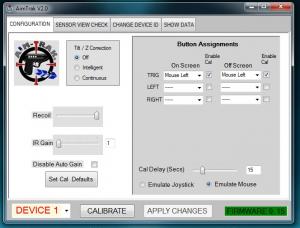

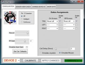

Setting up two AimTrak Guns in Mame
brucelee00
It takes time and patience. My wife did not want to be around me while i was working on this. I was so frustrated. Now we play all sorts of light gun games in utter bliss.

Not the result i was hoping for. i really thought that would be your answer. Hmm that is all i did once they both worked in windows. You said the cross hairs are the same color in mame? If so can you send pics of the aimtrak utility. 1 each for each device id?
Tried with bang, an when i hit tab then go to setup the axis's, it comes up as mouse and not gun this time. But just mouse x/mouse both for player 1 and player 2. So not only is it assigning the same for both players but it's saying mouse instead of gun.

OK! Progress! (just a side note before I get into this: my first gun is blue color, my second gun is red color, due to how i setup my control panel overlay. blue is left side red is on right side)
Klizine, made another mame folder for the test. Installed that version of mame you suggested. Used your mame.ini. Run hyperlaunch and area 51. Go to setup the axis's. Using device 1 blue gun, it registers as gun 2 for both x and y. Using device 2 red gun, it registers as gun 1 for both x and y. For whatever reason its doing gun 1 and 2 backwards idk, but idc. Because how mame is, or just how area 51 is idk, gun 1 is red crosshair, and gun 2 is blue crosshair. So it actually works out cause of the actual color of my guns. Only problem is the health on screen is opposite color, but idc, as long as crosshairs are correct color.
Now. Playing the game. Blue gun shoots and reloads fine. Red gun doesn't shoot the enemies or reload, although i have set the red guns trigger button in mame. Answers? Making headway guys! I think! (still would like no nag and highscore eventually)
Correction on the not shooting for second gun. Both guns working and reloading! Ill just have to make due with have my blue gun (left) having the red health due to how my control panel is setup.
Now...how to get no nag and highscore.
Also, for when I move everything from my test mame folder, when it comes to it should I just get rid of everything in my real mame folder and move the test folder stuff over?
The "Gun 1", "Gun 2" thing is how widows deals with identifying them... i've had it Gun 7 and Gun 8 odd, cause I don't have that many... but regardless.. AWESOME!!!
ok. so good news. you can change the colors of the crosshairs. In game hit Tab, then go down to Crosshair Options. You can then change the color to whatever you have in your crosshair folder for P1 and P2 crosshairs!!!
Sweet man! Yea I'm ok with the cross hairs. It's actually using them correctly per gun color. Red and blue health onscreen of backwards but that's only because me blue is oneft side instead. I'll deal
It's really up to you. But I would get rid of anything that hasn't worked up to this point. (Obviously don't junk your roms!)
So I was hoping this "technique" worked for you, and I can't explain why Jumpstiles don't work for us... but now... You get to compile your own MAME!!!! I don't mind writing something up. It's not too hard, so give me a lil bit.
** To switch the player 1&2 you'd have to change the Device ID with the Aimtrak utility. both my guns are black, so It doesn't matter to me.
That would be awesome if you could compile one for me. Thanks man! I don't know how to do that
Give a man a fish and you feed him for a day; teach a man to fish and you feed him for a lifetime. But I'll do both. I'll post my 64bit version on my folder on the ftp...
Ok. So I swapped device Ids in the aimtrak utility. But when I hit tab in Mame, now they are gun 3 and 4 for some reason and still same colors for health and crosshairs. So pretty much, nothing switched. Just gun 3 and 4
