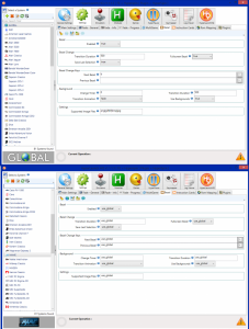

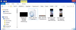

kenshutt97 Posted May 9, 2015 Posted May 9, 2015 I seem to have an issue with certain games in which the bezel is popping up in front of the background, but behind the bezel. I'm not super sure how bezels work as far as files. Does that background need to have the same naming convention? See attachments for a screenshot of what it looks like and then another for the files in that bezel directory.

kenshutt97 Posted May 10, 2015 Author Posted May 10, 2015 Sorry, I should have mentioned, that is with instruction cards turned off. Same issue happens with them on, only I have instructions on the side and mame window still shows up.

bleasby Posted May 13, 2015 Posted May 13, 2015 did you tried this? http://www.rlauncher.com/forum/showthread.php?324-MAME-console-window-problem&p=3643&viewfull=1#post3643 When asking for help for RocketLauncher, POST ON THE RLAUNCHER.NET FORUMS! Also, please post your RocketLauncher.log with logging level set to troubleshooting in pastebin (set the log level in RocketLauncherUI, global system > General Settings -> RocketLauncher). Ass. Bleasby - RocketLauncher Development Team.
kenshutt97 Posted May 13, 2015 Author Posted May 13, 2015 That did it...thanks. For some reason I saw that setting before and thought hiding emulator would hide the game too. Didn't think that one through. LOL. Thanks!
