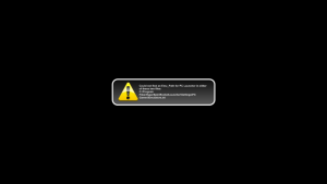

micahlee Posted May 10, 2015 Posted May 10, 2015 Hello, I am using RocketLauncher, and HyperSpin v1.3 and my PC Games will not start. I just started adding them, so I haven't actually started using them in hyperspin, only in RL. I set up my Emulator to be a virtual emulator, with PCLauncher as the module. When I add a PC Game, I do it through Modules->PCLauncher.ahk->edit system specific module settings. From here I simply link the application (exe) and try to launch the game from here. When I launch the game I get a message that RocketLauncher could not find an Emu_Path for PC Launcher in either of these two files: ...\Emulators.ini

micahlee Posted May 10, 2015 Author Posted May 10, 2015 I didn't place anything in there, it's the automatically generated files. emulators.ini contains this: [ROMS] Default_Emulator=PC Launcher Rom_Path= Other files are Bezel.ini, Games.ini, Pause.ini, RocketLauncher.ini

micahlee Posted May 12, 2015 Author Posted May 12, 2015 I found the answer in the rocket launcher forums. You need to set skip emu and rom checks in the settings for that system.
