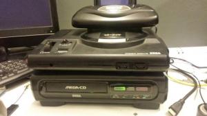

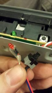

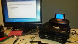

Well about 6 month ago I built this little thing as a bit of a folly
Hyperspin based emulator for the console I spent the latter part of my childhood playing. (Megadrive with its various add-ons)
using original controllers (had to happen - I don't understand people who emulate a console and then use xbox controllers or whatever)
With a "marquee" style monitor in the cartridge which displays the actual cart art for the game being played.
Started as faulty consoles sourced from ebay / facebook selling groups. etc

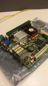

stripped them out and built a mini ITX PC as per usual.

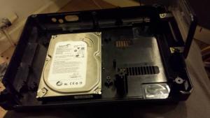

I added a 500GB sata hdd (ample for the sega 8-16 bit sets - which is all that will be running on it.)

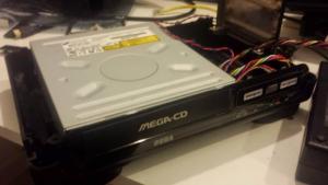

upgraded to a sata DVD rewriter so it can act as a DVD player too.

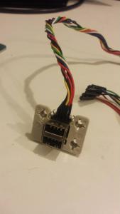

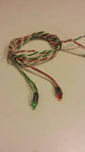

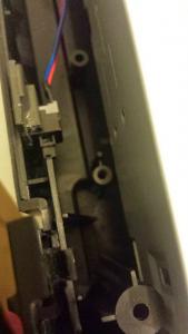

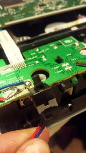

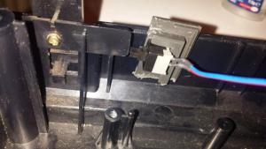

rerouted the LED and eject buttons to the correct locations in the MegaCD case. (parts raped from an old ATX case.

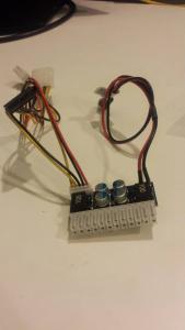

added a pico PSU to keep everything self contained.

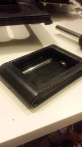

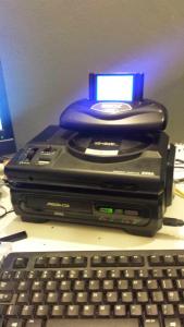

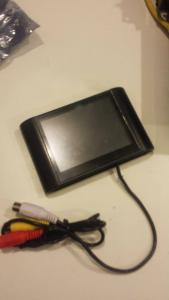

I hollowed out an original game cartridge and replaced the label with a small LCD display from a vehicle reversing camera (cheap as chips on amazon)

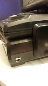

added HDMI out and a couple of USB ports for while I was building it and for adding a keyboard as and when required.
anyway have a look at the pictures attached, it should be pretty self explanatory as how it all went together.
Thanks, i think it totally finished the whole thing off, otherwise it would have been just another itx project in a megadrive case.

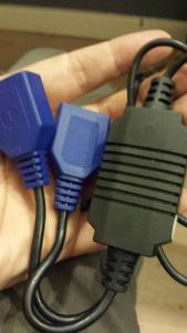

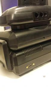

tried to re-use as many original parts as possible, even butchered the original controller ports from the broken motherboard as the ones on the retrobit adapter were shoddy.

Looks really good, i love it :) Probably I would left 32x out of the equation, md1+mcd1 looks really polished while 32x seems to be made for md2...

Well... NO!. Jaguar/jaguar cd had a ridiculous design BUT jaguar cd was (badly) made to fit jaguar. 32x on top of megadrive1 resemble a random piece of hardware glued into cart slot for no apparent reason (or most probably an indian totem for indian's devil worshippers) :P
32X on a md2/mcd2 looks much better... not a "real deal" but at last something you can live with...
