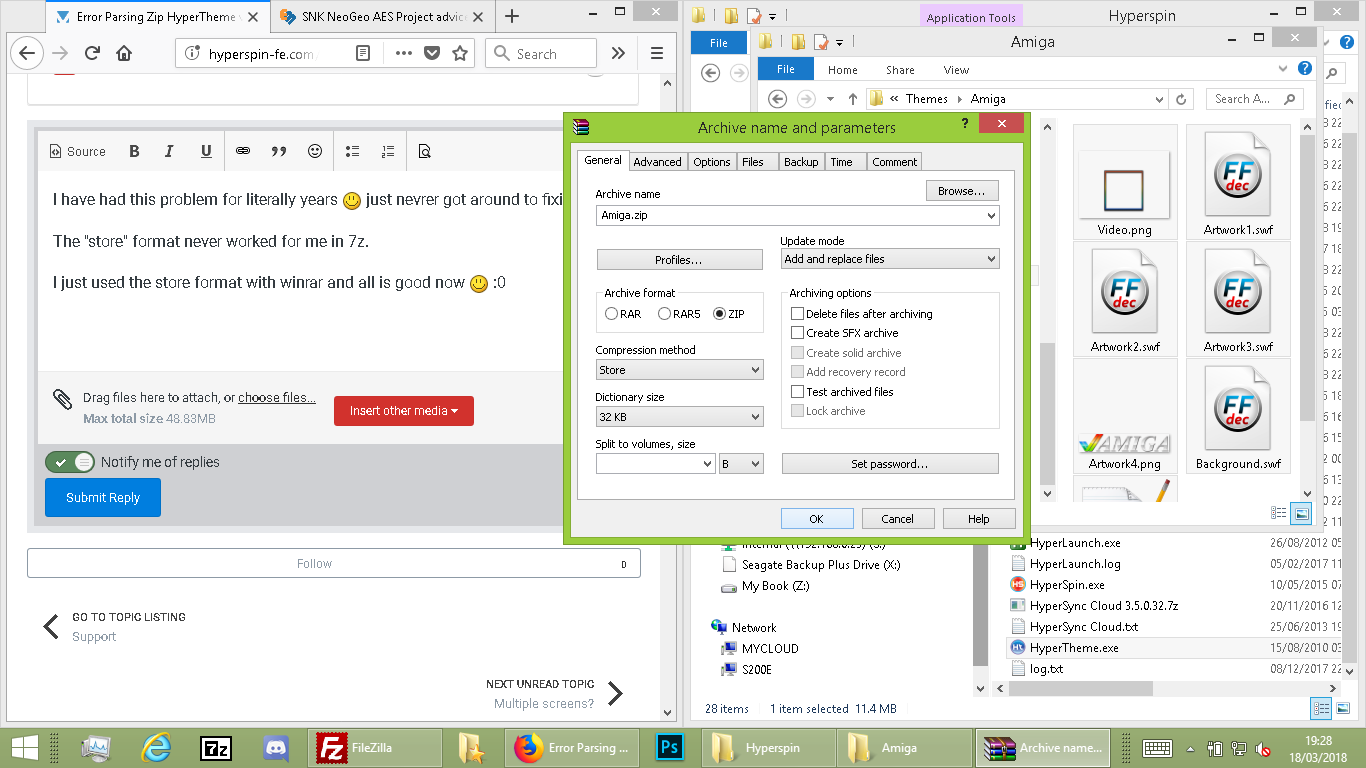

ghutch92 Posted September 26, 2014 Posted September 26, 2014 make sure you are not actually compressing the zip. In 7zip you would add to archive and choose the store option in compression level. http://sevenzip.sourceforge.jp/chm/fm/plugins/7-zip/add.htm How to Install HyperSpin and more RocketLauncher HyperSpin Startup Script
thatman84 Posted March 18, 2018 Posted March 18, 2018 I have had this problem for literally years just nevrer got around to fixing it! The "store" format never worked for me in 7z. I just used the store format with winrar and all is good now :0 Hyperspin 2.0 Latest Download Hyperspin 2.0 Documentation -------Pre Hyperspin 2.0 Below---------- HS Android Overview & Install HS Android Base Pack Download My Tutorials
