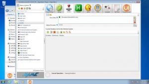

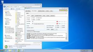

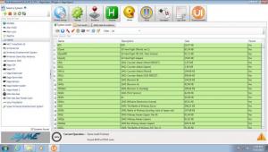

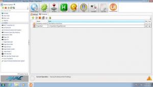

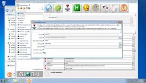

Jobber8742 Posted May 16, 2015 Posted May 16, 2015 I've been seeing this problem on the boards a lot, but I can't find an answer really anywhere. Maybe it's obvious, but I can't seem to figure it out. The roms will load fine in MAME. The roms will load fine in RocketLauncher, but the roms will not load in HyperSpin. I did a fresh install of HyperSpin 1.4 beta and RocketLauncher. It's my understanding that I didn't need to use that transition tool for HyperLaunch to RocketLauncher since the beta doesn't need it, but I can't get the roms to load. Any ideas what I'm doing wrong? Some screenshot are below to show how I have things set up. I've sort of followed Austin's video tutorial, except that I have created separate folders for emulators, rocketlauncher, and hyperspin. Folder structure looks like this: D:\Hyperspin D:\RocketLauncher\RocketLauncherUI D:\Emulators\Mame0161\mame64.exe D:\Emulators\Mame0161\roms

mobly100 Posted May 18, 2015 Posted May 18, 2015 It's all about the path: I changed my folder names to the below and changed the path and now its works! So if you cant launch games in Hyperspin and it works in Rocketlauncher...look in two places: Hyperlaunch_Path=C:\RocketLauncher\RocketLauncher.exe Click RocketlauncherUI click the rocketlauncherUI tab then click the frontends tab and make sure hyperspin in set as the front end. If hyperspin is not listed there add it!
