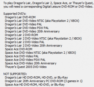

I updated my old version of Daphne and now DLair & Space Ace no longer work. Bummer.
Question 1.
After messing with it since 7am it seems I need to get the actual Digital Leisure DVD's to get DLair 1 & 2, Space Ace, Thayers quest etc... to work again.
But according to the pop-up it can either be PC versions or Playstation/Xbox versions? Is that right? Once I have the actual discs then Daphne will let me run any Rom version (such as enhanced 2.0) correct?

Daphne will download encrypted versions of the games DL, DL2 SA, and TQ
when you insert the DVDs the folder where the encrypted folder will double in size.
You will need to get the DVDs made by Digital Leisure  and say "Xbox compatible" on the cover.
shop around I"m sure you can get them for less then $15 each.   some "Pirate"  site by some unknown "bay" had disc images.  I personally never downloaded them and would encourage to purchase them from
digital leisure.  but I read somewhere that they no longer sell them so its off to ebay.

Ah I get it. It doesn't mean an Xbox version, it just said "Xbox/PS2 compatible" because they played DVD's then. Got it.
Yeah the Digital Leisure site doesn't show them for sale anymore. Amazon has them for about $25 each. I'll see what I can find.
