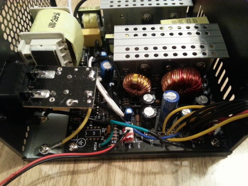

stripped the PSU, removed the excess wires (from the ATX connector) and then soldered the green wire and one of the ground wires together.
covered any remaining wires exposed ends with heat shrink tubing
