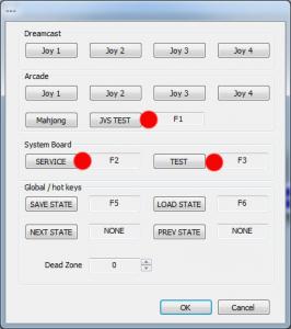

shitoken Posted June 16, 2015 Author Posted June 16, 2015 I have tried pressing F1 to get into service mode but it does not. I have already set service to F1 in pad setting.
gigapig Posted June 16, 2015 Posted June 16, 2015 Apologies, I forgot those are definable. Set keys as in the screen shot.
shitoken Posted June 16, 2015 Author Posted June 16, 2015 Brilliant Bro, thank you so muchDo we need to set Turn Card R/W to "Off". for each n every game? It does not save? everytime I start the game need to set this again? One thing is demul have a habit of illegal window shut down many times.
