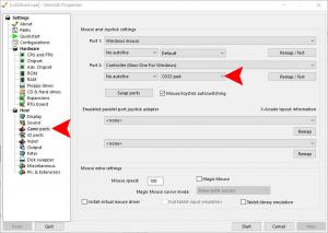

gigapig Posted June 17, 2016 Posted June 17, 2016 This may work for you I don't know as I don't use an ipac. So with the controller connected fire up WinUAE and load your Amiga or CD32 config. Click Game Ports in the left pane then look at Port 2. You will need to select you controller type from the drop down and under that next to Autofire (see arrow in the pic below) choose the Amiga Controller type. So if you are setting up for CD32 the choose the CD32 controller or for Amiga the Gamepad or analogue joystick. Save your config. You can then fine tune the controls with this guide if required. You can set up save and load here.

shitoken Posted June 20, 2016 Author Posted June 20, 2016 On 6/17/2016 at 8:30 AM, gigapig said: This may work for you I don't know as I don't use an ipac. So with the controller connected fire up WinUAE and load your Amiga or CD32 config. Click Game Ports in the left pane then look at Port 2. You will need to select you controller type from the drop down and under that next to Autofire (see arrow in the pic below) choose the Amiga Controller type. So if you are setting up for CD32 the choose the CD32 controller or for Amiga the Gamepad or analogue joystick. Save your config. Image 1.jpg You can then fine tune the controls with this guide if required. You can set up save and load here. Without removing exist mapped keys , failed to set new keys, How can I remove the existing?
gigapig Posted June 20, 2016 Posted June 20, 2016 The Input Target I think relates to the Amiga control method so probably can be changed. Depending on what you want to do you would assign [Port2] Joy2 Vertical [Analogue] to a different input source. Which control method did you choose under Game Ports
shitoken Posted June 21, 2016 Author Posted June 21, 2016 On 6/20/2016 at 5:01 PM, gigapig said: The Input Target I think relates to the Amiga control method so probably can be changed. Depending on what you want to do you would assign [Port2] Joy2 Vertical [Analogue] to a different input source. Which control method did you choose under Game Ports I have choosed port 2 > i-pac ultimate No autofire > analogue joystick
gigapig Posted June 21, 2016 Posted June 21, 2016 On 6/21/2016 at 7:32 AM, shitoken said: I have choosed port 2 > i-pac ultimate No autofire > analogue joystick Which is fine if you want to use the Amiga's original "analogue joystick" as the control method. Your control method is the ipac, WinUAE will convert that into the Amiga analogue joystick.
