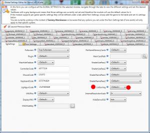

gigapig Posted June 28, 2015 Posted June 28, 2015 You can set it here in RLUI but some games need it on or off, so if you see glitching you'll need to set the opposite per game.
