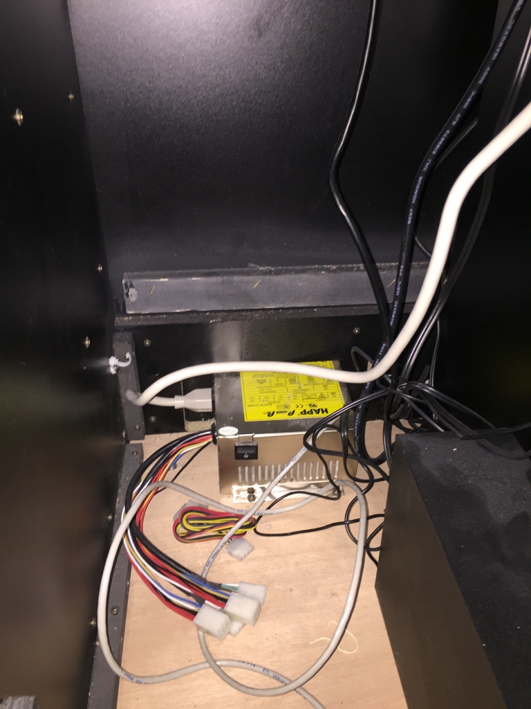

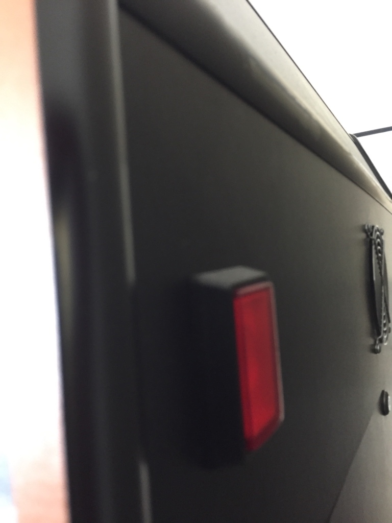

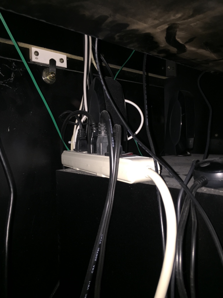

ninja2bceen Posted June 20, 2015 Author Posted June 20, 2015 Here is the inside. So why was it mounted there by default? I purchase this one... that's the power supply and the white cord is the surge protector Here is the surge protector I have a trackball that lights up blue but don't have ledblinky. I also have a button for a single to turn on everything but I don't actually have anything hooked up to it but the cabinet has a button ready. Sorry noob here discovering what I have Button on the back not hooked up to anything (Tapatalk) Advance the cause to 100%. http://hyperbase.hyperspin-fe.com/ Planet Geekdom, Subscribe for Tutorials! https://www.youtube.com/channel/UCdcby-s2GwriaOHGmVC2vGA?sub_confirmation=1&app=desktop
Metalzoic Posted June 20, 2015 Posted June 20, 2015 Power supply was probably there for running a standard monitor + Jamma/Neo-Geo board type arcade setup. That's my guess. That button is cool. Should work like mine if you can connect it to a PC motherboard pin type wire and if you can figue out where to plug it in on the motherboard. I just followed the wire from the power button on my PC case.
ninja2bceen Posted June 20, 2015 Author Posted June 20, 2015 Can you tell me more how I would get my pc hooked up to that button? That button is hollow as if I need to put a button in it? What do I plug up from there? Got a tutorial? I can take pic of the cab and monitor. I don't think is a standard monitor. Do out of the box psu have the nice wore connections already? It's pretty organized it looks like. It also has a mini fan at the back of the cabinet, it's mighty loud. Are their fans that are quiet? It just pushes the air out of the cabinet itself. Maybe I should make vents on the top instead? Your ultimate suggestion is just unplug the psu and plug in the surge protector instead? Psu serves no purpose with the surge protector? (Tapatalk) Advance the cause to 100%. http://hyperbase.hyperspin-fe.com/ Planet Geekdom, Subscribe for Tutorials! https://www.youtube.com/channel/UCdcby-s2GwriaOHGmVC2vGA?sub_confirmation=1&app=desktop

Metalzoic Posted June 21, 2015 Posted June 21, 2015 My guess is the original purpose was probably to have it power actual arcade, real hardware. Such as Jamma or Neo-Geo arcade motherboards with game cards/carts, Arcade CRT monitors that don't just plug into a normal outlet, wired lighting, coin slots etc... My real arcade machines both have a mounted power supply like that. But our Hyperspin machines use PC's which already have a PSU, so it seems to me to be redundant. I'm no expert though. As for wiring your PC to a button there were topics about it at arcadecontrols.com I believe. I think I just googled something like "wiring arcade power button" or something. Good luck!
