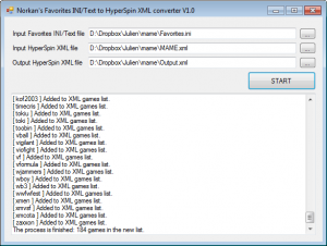

norkan Posted August 5, 2015 Posted August 5, 2015 Hello I have developped an application for Windows to do that. Here is the link for download. It was developped on Windows 7 and needs .NET framework 4.0 or greater. I use it this way: I setup my mame's favorites text file as input 1 I setup the full MAME XML hyperspin gamelist as input 2 I choose the output xml file The result is an xml file structured as an hyperspin xml file but limited to the games listed in your MAME's favorites text file. It can build Hyperspin XML list from games text list like: 1942 1942b 1944 64street aburner2 airwolf altbeast aof ... and produces <?xml version="1.0" encoding="utf-8"?> <!--This file is generated by Norkan's Favorites INI/Text to HyperSpin XML converter.--> <menu> <header> <listname>MAME</listname> <lastlistupdate>05/12/2014</lastlistupdate> <listversion>.153 Ongoing</listversion> <exporterversion>HyperList XML Exporter Version 1.3 Copywrite © 2009-2011 William Strong</exporterversion> </header> <game name="1942b" index="" image=""> <description>1942 (First Version)</description> <cloneof>1942</cloneof> <crc></crc> <manufacturer>Capcom</manufacturer> <year>1984</year> <genre>Shoot-'Em-Up</genre> <rating>AAMA - Green (Suitable For All Ages)</rating> <enabled>Yes</enabled> </game> <game name="1942" index="" image=""> <description>1942 (Revision </description> <cloneof></cloneof> <crc></crc> <manufacturer>Capcom</manufacturer> <year>1984</year> <genre>Shoot-'Em-Up</genre> <rating>AAMA - Green (Suitable For All Ages)</rating> <enabled>Yes</enabled> </game> ... I hope this will help ? Norkan Screenshot and app are joined to the post Favorites to HyperSpin XML game list converter.rar

norkan Posted August 5, 2015 Posted August 5, 2015 It is the same mecanism as for genres lists so it should work well: test it I use it only to build roms packs, not yet for hyperspin menu.
