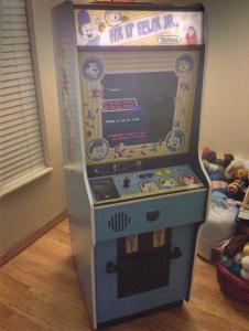

markdivine Posted July 12, 2013 Posted July 12, 2013 Hey Guys! Sjaak!, RidicRick!I super excited, my FiFjr Cab is Getting really close to being finished! Sjaaks Version is the Best so far!, I haven't tried BBB's yet though... Wow great job Sorhp! Show me some pictures of your work inside. Did you use a Jpac?

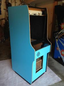

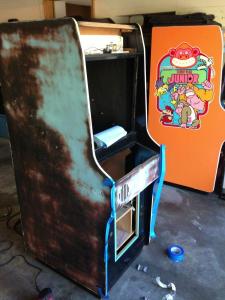

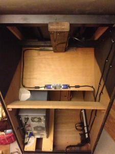

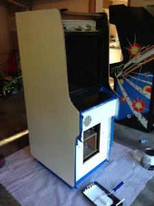

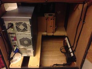

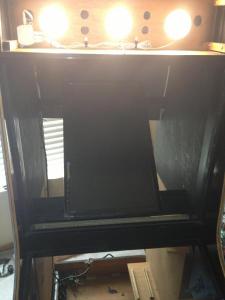

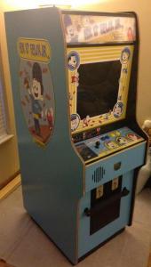

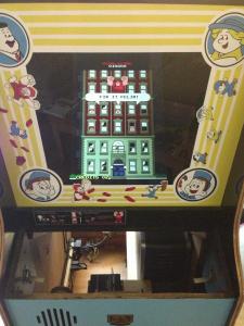

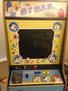

WVISION Posted September 13, 2013 Posted September 13, 2013 Mine's coming along.. Just a few more exterior things to finish ie Trim. Then onto control panel wiring and pc mounting. Went LCD with a scanline generator. A little lighter that way. Haven't heard back from Sjaak so went a different way for now.
frostyfire03530 Posted September 14, 2013 Author Posted September 14, 2013 It looks great! Where'd you find the cab? From the lockbar over the coin door it looks like it was in fair use before you got a hold of it. Any other pics to share?
WVISION Posted September 16, 2013 Posted September 16, 2013 Thanks, I'm really happy with how it turned out. Yep your right it was an Amusement Cab with lock bar. I know a few folks in the amusement industry so occasionally I call to see if they have a end of life cab that needs a good home. Found an old cab that was a guerrilla war snk conversion. Well it was panted black and while sanding it was blue behind it. Further inspection and it was a DK cabinet a long time ago think it was a 5000'ish serial. No boards or monitor so far from anything that was destroying a good game. 3 coats primer and 3 coats Liquid Blue and it was back in shape. I decided to keep the lock bar thought it added character. So I plasti dipped it and added some brass spacers to move it away from the door just to prevent damage. Has an old retired HP I had laying around and added a Lono Arcade to USB controller with Xpadder. Amazon had a little Lepai 20watt mini amp to drive the speaker. 16:9 24"LCD screen by ASUS has a 4:3 aspect mode built in so that worked out well. Added a SLG 3000 scan line generator.. Artwork is Ricks although I did color correct it to match the the arcade cabinet colors and adjusted button location to fit a DKjr CPO. I used Disney paper craft model to match colors off of. My local sign shop just got their new printer in so i was their test subject. Might have them print the Marquee double pass but was not complaining as everything turned out great! Just have to vent it for the pc fan to exhaust.

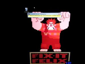

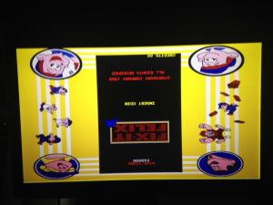

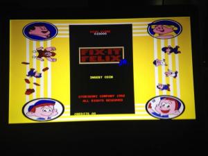

mrxtreme Posted November 15, 2013 Posted November 15, 2013 First Thank you all for this thread it has helped out! and everyone is badass for contributing audio and art and everything to make this come to life I got everything working in hyperspin and I can exit the game by pressing ESC which is cool and i havnt configured any buttons yet because I dont have anything yet besides my keyboard but when i run the script the game is in the middle where i want it but the bezel is zoomed in and off. like the pic below can anyone check my ahk and see what im missing or did wrong please? any help is much appreciated! GamePath=F:\FULL HYPERSPIN FOLDER\Hyperspin\Emulators\Fix it Felix Jr\FixitFelixJr.exe ; the full path and exe of FixitFelixJr.exeBezelPath=F:\FULL HYPERSPIN FOLDER\Hyperspin\Emulators\Fix it Felix Jr\bezel.png ; the full path and extension to bezel file zoom=200 ; Frame Resolution-Only 33,50,100,200 are supported YAdjust=0 ; adjusts vertically how far off center from the middle of the screen, 0=center, negative value moves up, positive value moves down XAdjust=0 ; adjusts horizontally how far off center from the middle of the screen, 0=center, negative value moves to left, positive value moves to right title=ahk_class FOCAL Test Shell exitkey=Esc ShowBezel=true BackgroundColor=yellow ; changes background color, see here for available colors: http://www.autohotkey.com/docs/commands/Progress.htm#colors HideTaskBar=true ; rotation=90 ; still need to rotate monitor, no point in having enabled ;---------------------------------------------------------------------------------------------------- Hotkey, ~%exitkey%, Close WinHide ahk_class Shell_TrayWnd WinHide, ahk_class Button SplitPath, GamePath, fileName, fileDir Gui, Felix1: New, -Caption +ToolWindow +OwnDialogs Gui, Felix1: Color, %BackgroundColor% If ShowBezel = true Gui, Felix1: Add, Picture, W%A_ScreenWidth% H%A_ScreenHeight%, %BezelPath% Gui, Felix1: Show, x0 y0 h%A_ScreenHeight% w%A_ScreenWidth% ; rotation := If (rotation=90 || rotation=180 || rotation=270) ? " -rotate=" . rotation . " fullscreen" : "" zoom := If (zoom=33 || zoom=50 || zoom=100 || zoom=200) ? " -zoom=" . zoom : "" Run, %fileName% %zoom% %rotation%, %fileDir% WinWait, %title% WinActivate, %title% winHwnd:=WinActive(title) WinSet,AlwaysOnTop, On, %title% WinSet, Style, -0xC00000, %title% ; Remove border and titlebar DllCall("SetMenu", uint, winHwnd, uint, 0) ; Remove the MenuBar MouseMove, %A_ScreenWidth%, %A_ScreenHeight% ; Met la souris hors écran CenterWindow(title) Process, WaitClose, %fileName% ExitApp ;-----Control Remaps----- ;~3::c ;Insert Coin ;~?::1 ;Start Player 1 ;~?::2 ;Start Player 2 ;?::{Left} ;Move Left ;?::{Right} ;Move Right ;?::{Up} ;Jump Up a Level ;?::{Down} ;Jump Down a Level ;?::x ;Fix-It ;?::{LButton} ;Jump ;?::{Shift} ;Fix-It ;?::{F5} ;save ;?::{F6} ;FrameSkip ;?::{F7} ;ScreenShot ;?::{scrlk} ;lock mouse crosshairs to center of screen ;------------------------ CenterWindow(class) { Global YAdjust Global XAdjust WinGetPos, appX, appY, appWidth, appHeight, %class% appXPos := ( A_ScreenWidth / 2 ) - ( appWidth / 2 ) appYPos := ( A_ScreenHeight / 2 ) - ( appHeight / 2 ) WinMove, %class%,, % (appXPos+XAdjust), % (appYPos+YAdjust), appWidthNew, appHeightNew } Close: WinClose, ahk_class FOCAL Test Shell WinShow, ahk_class Shell_TrayWnd WinShow, ahk_class Button Return
Min2001 Posted November 15, 2013 Posted November 15, 2013 That is how the game is coded the zoom is hardcoded into the game and can only be run at 33, 50, 100 and 200. You have it set at 200, this cuts off the screen at the top and bottom when it is resized as it is resized too big. You can set it to run at 100 (I have mine set to this) which will preserve the top and bottom of the game but the game will be smaller and in the middle of the screen. Also your bezel is way too big (but maybe due to the zoom level) Edit: oh I see you wanted to keep the game like this I do have a bezel that I modified for my 16:9 widescreen here if you want to test that with it (1920 x 1080 Widescreen Bezel)

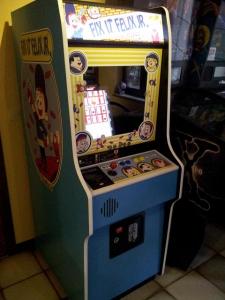

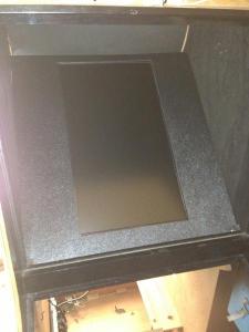

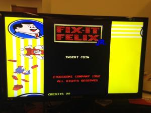

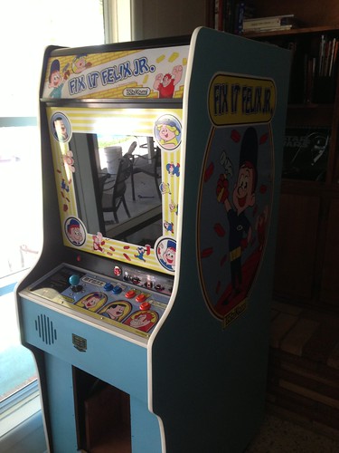

Arcadia Posted November 24, 2013 Posted November 24, 2013 Ok here is my cab: I'm using the game from Warrior Poet (many many thanks for this!). Everything works great but I still have some questions. I have set up a shortcut of the exe to the startup folder of windows so the game launches when the computer has booted. For now I'm going to keep this cabinet as dedicated so no other games on there. Every time the exe launches I get the following box: It asks to overwrite 2 files, one being the original FIF.exe, and I have to press the A button 2 times (or the Y for yes) before the game can launch. I have set these buttons as shift buttons on the ipac now so I don't have to open the cab and use the keyboard but it would be nice if it would boot straight away. Anything I can do about this? What is the best OS to use? I'm using Win7 now and it seems to run good. Any advantages to XP or others? Ow yes, the woodwork and decals where entirely made by Sjaak! I did the technical part.
