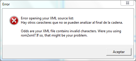

I have a Bug, When I try scanner Super Famicom.xml it say "post-69685-14287058974_thumb.png
In the Xml is all ok, don´t rare characters how "&", after I try with Super Nintendo.xml and it is OK !!!! LOL
Can you say me how fix it ?? Please
Sir Cyrano: Open the XML in your Notepad replace all "&" with "&" first and then replace all "&" with "&". Without the quotes of course.
I usually need to do this because very often there's one or two ampersands in custom XMLs that aren't formated correctly.
That worked for me with DamnedRegistrations' SFC database at least.
