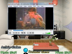

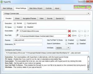

earthprime Posted August 1, 2015 Posted August 1, 2015 Thank you for the VLC module. I've successfully setup my 'Movies' wheel and think that all of my settings are correct. However, VLC launches in windowed mode (despite the WIN setting in HyperHQ) and I have to manually close it with my mouse once a video finishes playing. I've attached screenshots of this happening, including HyperHQ and Rocketlauncher settings with the VLS module. Can someone review and let me know if they see something wrong? I'd expect my movie to fade in and play seamlessly with VLC and then fade back to HS when finished. Thx.
earthprime Posted August 1, 2015 Posted August 1, 2015 You're awesome, that fixed it. When I play a video it now shows the LOADING screen and plays the video, then fades back to HS. I notice that the voice saying "Loading Complete" starts when my video starts, so there is overlap with the audio. Is there a way to stall the video for a second or deactivate the "Loading Complete" sound for my movie wheel only?
