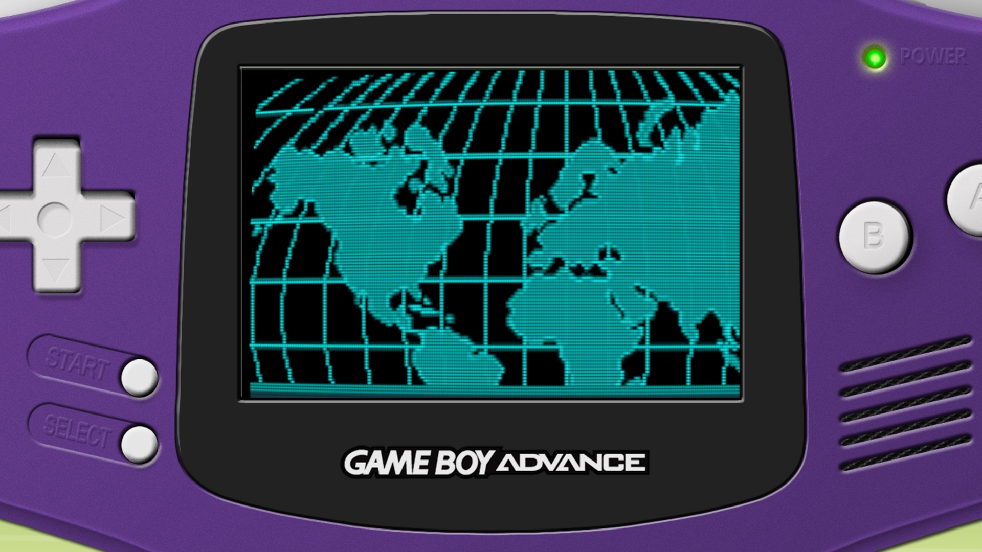

Rotgut Posted September 11, 2015 Author Posted September 11, 2015 Path for your artwork should be ":\RocketLauncher\Media\Bezels\Nintendo Game Boy Advance\_Default" If your not using RetroArch (I see in other posts you have mentioned you can't get it working) tell us the Emu your using and I/we will test it. 20150910130001.jpg Thanks for the info, guys. I was a bit sauced last night, sorry for the rudeness. I watched your new vid, Austin... nice! Thanks for that. So here is my path: C:\Program Files\HyperSpin\HyperLaunchHQ\Media\Bezels\Nintendo Game Boy Advance\_Default Inside that _Default folder are the three files from Austin: Bezel - 16x9 Nintendo Gameboy Advance (Austin585).ini Bezel - 16x9 Nintendo Gameboy Advance (Austin585).png Thumbs.db The emulator I am running: VisualBoyAdvance-M I am able to get a fade going (finally) but no matter what game I run, no bezel shows up at all. I have "Bezel Enabled" set to true in HyperLaunchHQ Again, I did grab the three files from Austin's Mega download, off the YouTube vid. I'm at a loss. Any thoughts/advice?

Rotgut Posted September 12, 2015 Author Posted September 12, 2015 Unless that is a typo your path is wrong. Bezel go in the HyperLaunch\media folder not the HyperLaunchHQ\media folder.The only folder I have with the name HyperLaunch is a HyperLaunchHQ folder inside my HyperSpin folder. I changed the name to HyperLaunch to see if that was the issue but it didn't make any difference.Anyway, here is a screen grab of what I have going on, maybe you can spot something I am not doing correctly?
