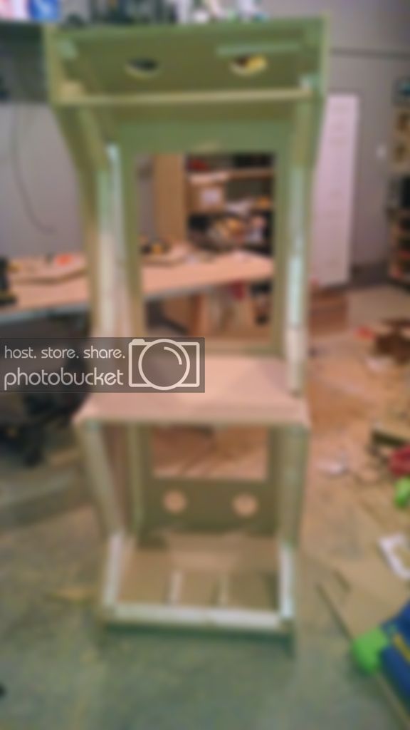

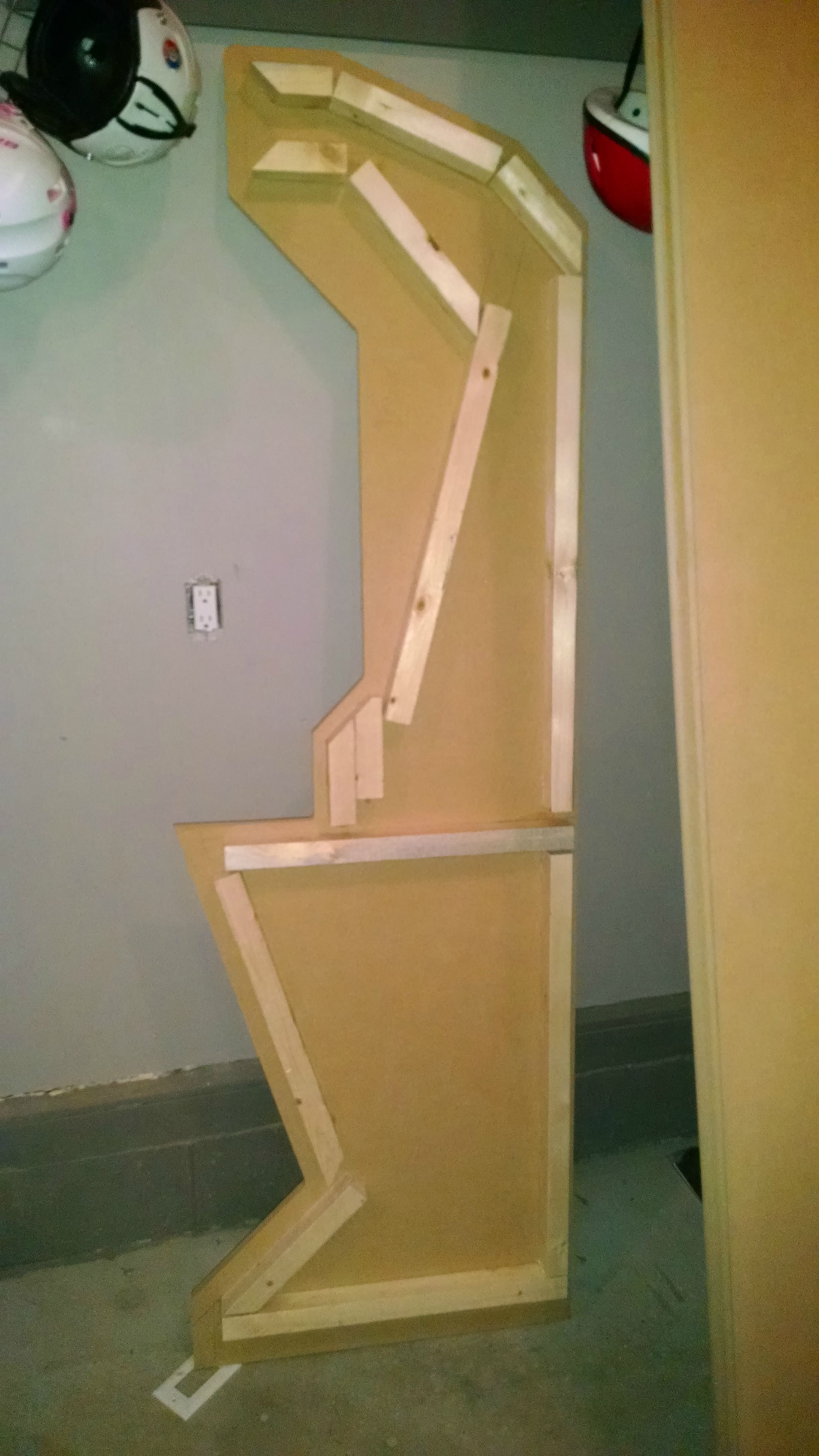

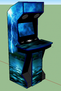

Frank Drebin Posted September 17, 2015 Posted September 17, 2015 Whats up! I posted over on BYOAC but thought I'd broaden my horizons for input over here. Long story short, my first hyperspin cabinet is gone, sold to the brother in law for cost of materials. Looking to build a more polished machine than the first one. Not that it was bad, but just spend a bit more time on the carpentry and design of it. There is a fella over on those forums who I owe a lot of credit to, OND. He has a thread over there that shows step by step how to build a machine, with plans. I'm taking some of his ideas, some of mine, and trying to tie it all together with some artwork yet to be decided. New design, like I said I'm not sure on artwork but I think I'm leaning towards a lighting theme (I'm not a huge fan of any game in particular, so I'd hate to build a MK cabinet when I really don't like MK) so I'd like to keep it kind of generic. Monitor will be 24" LCD. Not sure about computer yet. Maybe you guys can help me out there? Also no experience with either but damn intrigued by LED blinky and howler controls. Input on both much appreciated. Here's a pic of my proposed machine, and the old machine in her new home.

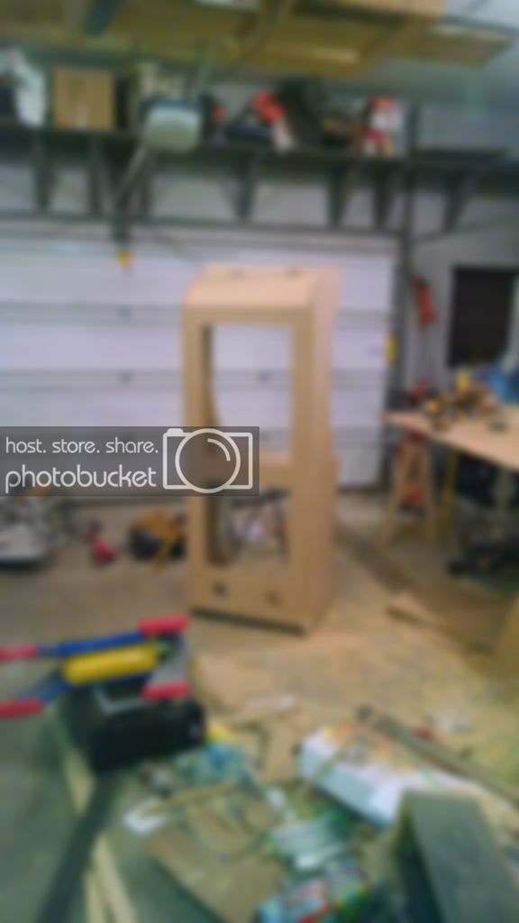

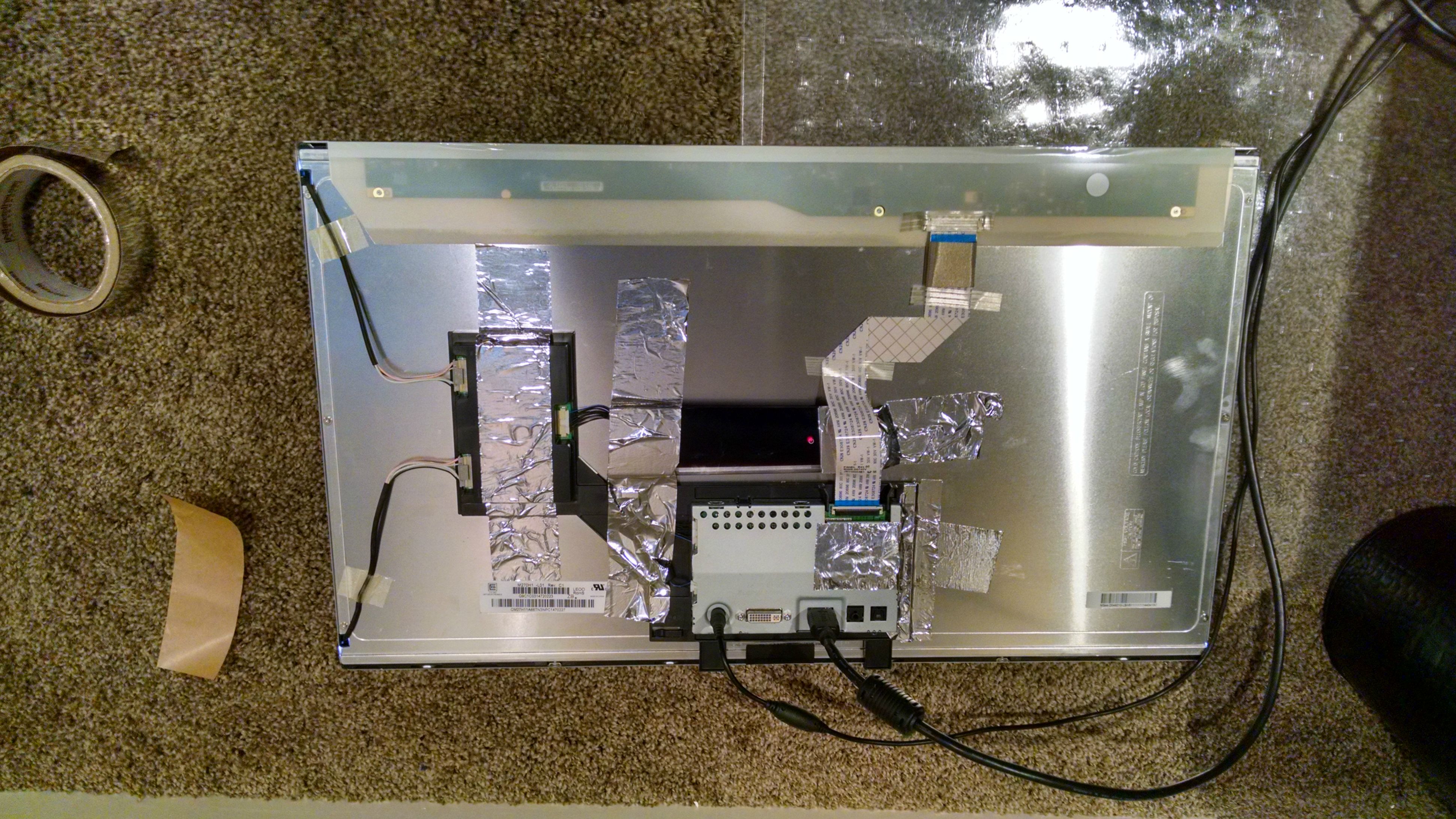

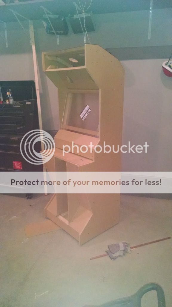

Frank Drebin Posted September 29, 2015 Author Posted September 29, 2015 Sawdust! Also de-cased the monitor:

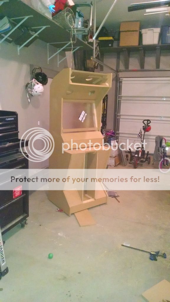

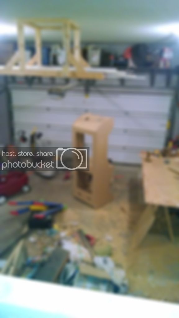

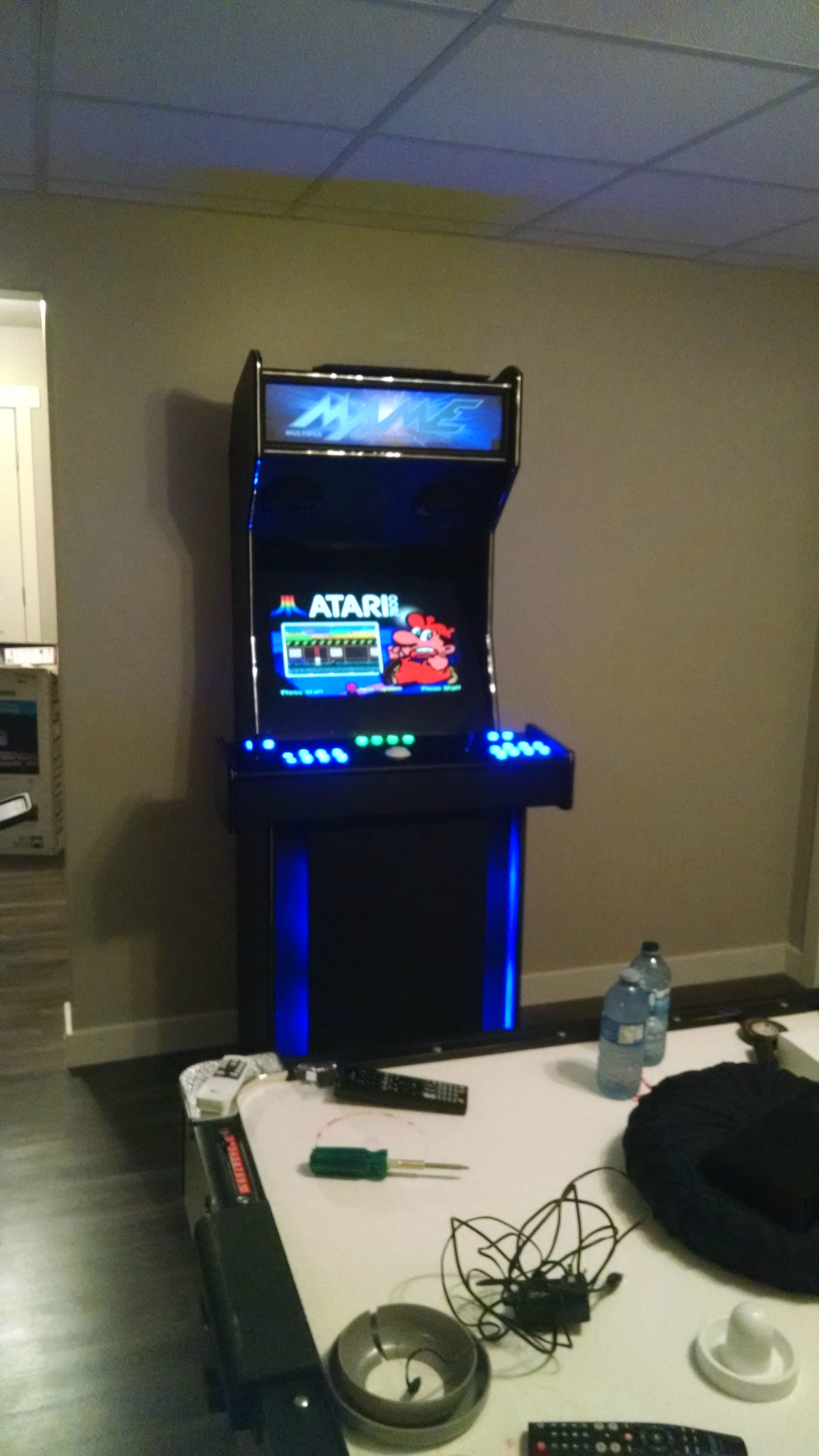

Frank Drebin Posted September 29, 2015 Author Posted September 29, 2015 Here is my first build in its new home:

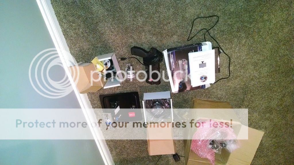

Frank Drebin Posted October 12, 2015 Author Posted October 12, 2015 Goodies are starting to come in the mail almost daily Here's the order from Ultimarc: 1 - Servostik 1 - J-Stik Spinner Translucent RGB trackball Aimtrak Gun Ultimate IO interface Dozen buttons for admin/various.

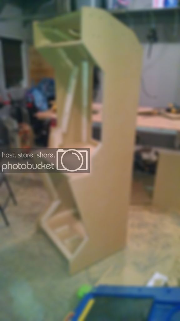

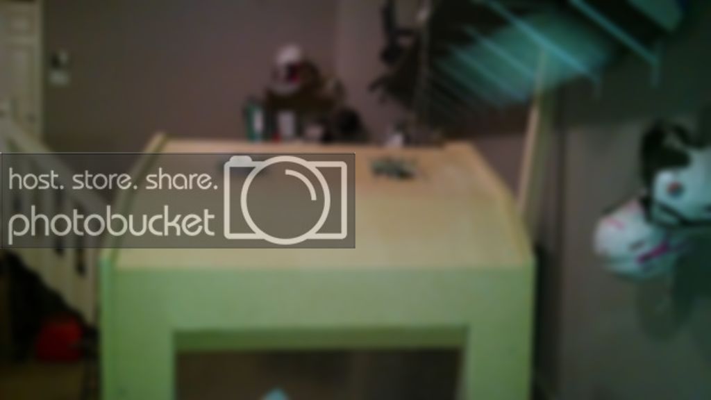

Frank Drebin Posted October 12, 2015 Author Posted October 12, 2015 Most people get all excited when that stuff comes in not me I prefer the woodworking side of everything!!! Each one gets easier to wire and configure but still not my favorite part!!! I assume with the build you have in mind the trackball will be lit up Blue?? Oh please let us know what you think of the gun!!! I haven't used one of those from aimtrak yet!! Nah I love the woodworking part of it too. I'm 90% about the building and 10% about the playing. I havent decided on a color yet but I am going themeless and wrapping it with auto vinyl. I ordered a sample book of 75 colors from Vvivid vinyl so it should be fun picking out a few to work together. Thats why its nice going with RGB. Will definitely report back on the aimtrak. Little update, got the "feet" done.

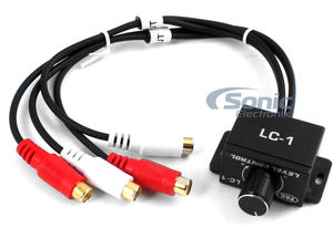

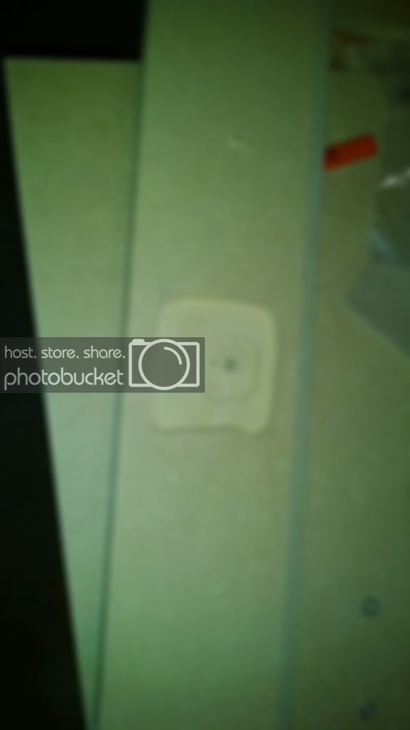

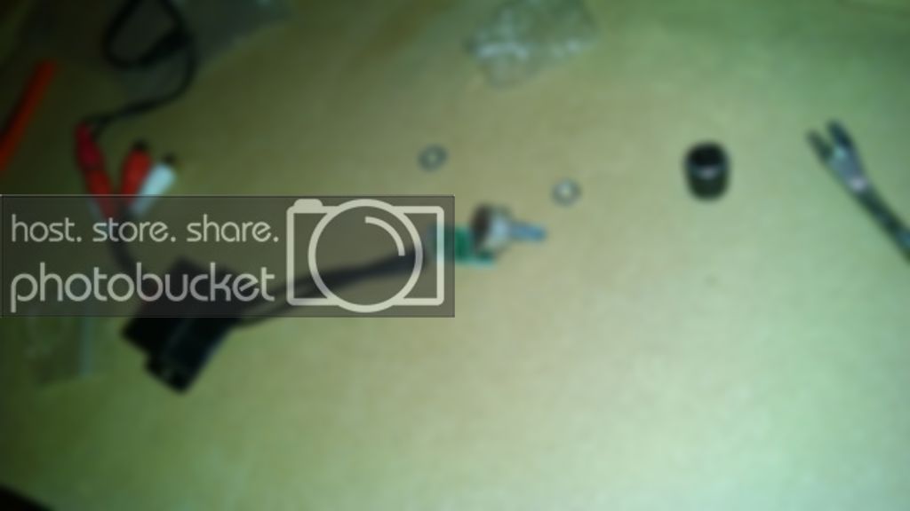

Frank Drebin Posted October 15, 2015 Author Posted October 15, 2015 Volume control: So I'm using an old set of Logitech 2.1 speakers. Fortunately these speakers are 4 ohm (same as car audio) so I will use the subwoofer/control unit and exchange the 2 front speakers for 4" car speakers which are easy to mount and look good on a cabinet. For volume control I'm using a PAC LC-1 which primary use is in car audio for subwoofer control, but the principal is the same: In line with one of these from the computer: http://s3.amazonaws.com/shopperplus/uploads/product/image/306355/medium_1.jpg And one of these to the speakers. http://s3.amazonaws.com/shopperplus/uploads/product/image/305079/medium_1.jpg Both computer and 2.1 volume will be on max by default and volume will be controlled by the LC1 knob. LC1 stripped of its housing: Mounting area routed to ~1/8" thick Volume knob in place on cabinet: You can get all kinds of volume knobs if you want. I got a larger diameter one coming in the mail to match the arcade buttons on the admin panel better.

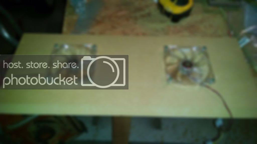

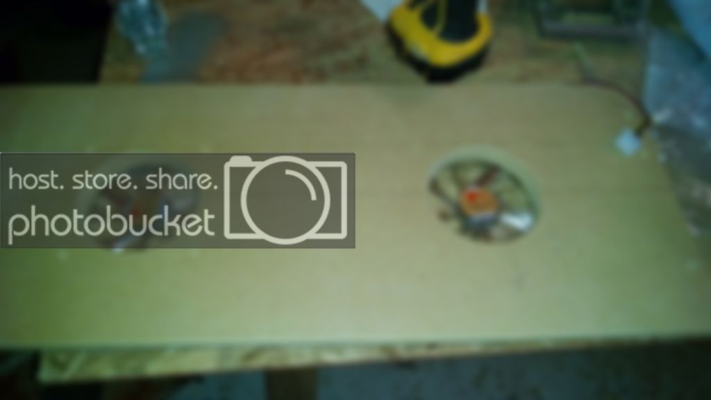

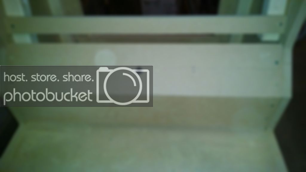

Frank Drebin Posted October 15, 2015 Author Posted October 15, 2015 Pre-drilled for cabinet fans/guards and speakers:
