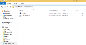

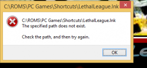

nezul Posted October 23, 2015 Posted October 23, 2015 Hey Yall,I think im starting to understand the madness that is Hyperspin.....So I have been trying to figure out how to install PC games into Hyperspin. A simple task by most stretches of the word except, most tutorials I find are either out of date (using a older version) or use either ONLY RocketLaunch or ONLY HyperLaunch.Anyway, so I tried adding ReMooD (4 player split screen doom) to Hyperspin, I could get it to run normally, I could get it to run through RocketLaunch, but for whatever reason i could never get it to run through hyperspin, I always ran into an error.Some many hours later and a small break, I sat back down, changed something.....and it worked. Hurray!cannot for the life of me remember what I did, but it worked.Now I go and add another PC game to the list an-----why do I have this exact same error? What did I do!?!?! How did I fix this before!?!Anyway so im getting this error.....but it makes no sense.NOW, Doom works fine and Lethal League is installed the exact same way as I installed Doom, Doom works, Lethal League does not. Could someone please shine some light on this madness? :3Thank you
