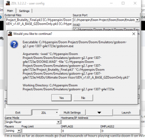

Metalzoic Posted January 9, 2016 Posted January 9, 2016 I'd rather launch it from a .bat file with the correct command line if possible. But the command line ZDL gives doesn't let you copy/paste it. I'll try to retype it without making a mistake, but I'm not sure what the structure should be. I'm guessing I leave out the "Executable", "Working Directory" text, but does the rest just go in one big line?
Metalzoic Posted January 9, 2016 Posted January 9, 2016 Hmm.. Thanks, I'll play with it some more (gave up earlier). I'd be launching GZdoom via ZDL though, not RocketLauncher and the Command line stuff ZDL shows is an entire paragraph long. I think a command line that convoluted is beyond me, but I also really, really don't want to have to use a RL module for it.
Metalzoic Posted January 9, 2016 Posted January 9, 2016 I'm an UltraHyperNoob! ZDL is just the recommended launcher GUI to use with Project Brutality (it's in the instructions for the mod). Here's what ZDL shows as a it's command line instructions: And here's what I typed into my .bat (as a single line... is that right?) C:/Hypespin/Doom Project/Doom/Emulators/gzdoom-g2.1pre-1307-g4e1723e/gzdoom.exe -iwad "C:/Hyperspin/Doom Projet/Doom/Doom/Emulators/gzdoom-g2.pre-1307-g4e1723e/DOOM2.WAD" -file "C:/Hyperspin/Doom Project/Doom/Doom/Emulators/gzdoom-g2.1.pre-1307-g4e1723e/Project_Brutality_Final.pk3" "C:/Hyperspin/Doom Project/Doom/Doom/Emulators/gzdoom-g2.1.pre-1307-g4e1723e/HUDs/Ultimate Doom Visor/UDV_v1.61_A_BASE_GZDoomOnly.pk3" That's in my .bat, but double clicking it just flashes a white box on the screen and nothing starts. Not sure if I should add that "working directory" bit at the bottom somehow?
Metalzoic Posted January 9, 2016 Posted January 9, 2016 Thanks. Spotted a couple other mistakes to (Project missing a c, path missing a Doom/ etc...) Still doesn't fire though. At least I feel closer! Thanks man.
