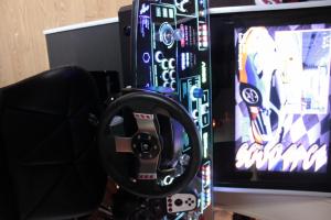

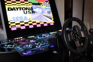

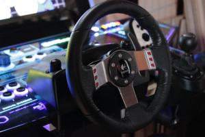

Discovered a happy compatibility the other day - it turns out the Logitech G27 mounts nicely to this control panel if you use a simple little jig.  I need to play test a few games to make sure it doesn't get lose with gameplay (force feedback, shifting, turning etc) but the fit seems good so far!

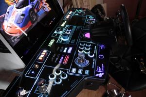

love this panel very cool! best i have seen. if you ever want to nudge it up a bit (the cab) get the led t-molding
Thanks man!
Given the approach already employed on this thing I feel like the LED t-moulding might not work for this build.   With the current aesthetic there's a quasi-industrial/commercial baseline whereas the LED t-moulding could add a slick "mod" feel to the whole idea.  Kinda like putting ground lighting on a rocket or something.  Two different worlds colliding. The LED t-moulding is really awesome though. Works beautifully for TRON cabinets and "futuristic" aesthetics.
