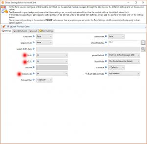

Here is how I have things set in RLUI highlighting the areas of interest for you.
post-2819-0-69966400-1448187534_thumb.jp

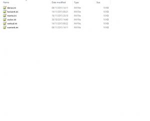

And the files I have in my ini folder.
post-2819-0-92183800-1448187596_thumb.jp
