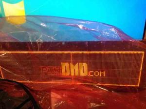

neohusky Posted June 12, 2013 Posted June 12, 2013 Hi Guys Sadly I haven't had a chance to work on my cabinet for many months. I've had an opportunity to play with my test bed again and setup the DMD I received in Feb On powering it up I noticed a vertical line through the centre of the DMD and a single pixel in that line absent. I'm a little disappointed that this new DMD (still in plastic) is faulty. I should have put it through its passes when I first got it. Virtua pin have been gracious enough for a discount on my next DMD purchase, but, can't do anything about this one as its been more than 30days since me receiving it. Has anyone had this issue before? If so what did you do about it? Is there any chance of successfully repairing this? I apologise for the crappy picture. To know, is to know that you know nothing. That is the meaning of true knowledge.

neohusky Posted June 14, 2013 Author Posted June 14, 2013 The reply from Vishay: The LED which does not light has failed and shorted, causing the other LEDs in that column to light when they should not. (The cause may be an LED manufacturing defect or ESD damage.) The 8x8 LED module with the failed LED must be replaced. They have asked that I return the display to Vishay for repair through the distributor. I will try and see if Virtuapin can help with the return. To know, is to know that you know nothing. That is the meaning of true knowledge.
russdx Posted June 14, 2013 Posted June 14, 2013 Most likely manufacture defect of the LED segment, I cant see how esd would just kill one led out of 4096 hehe. Hopefully they repair it!
