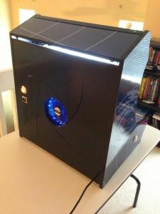

Frosty Posted June 20, 2013 Posted June 20, 2013 HiYes mine will be raised slightly too but i dont think i will have room for any slots on the bottom. Im hoping the gap at the front will allow cool air to come in as i wont have any room to put a fan to suck cool air in to the bartop. I was thinking of a large led fan myself to blow out the warm air. does anyone have a link to a quiet and decent large fan in the uk? Seems like you are in the same boat I was. I just have one 120mm fan exhausting warm air OUT of the cab. With the slot in the front bottom cool air seeps in' date=' making a decent airflow. I haven't had any problems. Just test monitor your temps w/ a graphically intense game to see how it goes.
Shepster34 Posted June 20, 2013 Author Posted June 20, 2013 Nice cab. What processor do you have running. Im hoping the haswell cpu runs fairly cool as its supposed to be good on power. Did the fan take much fitting? This may be a stupid question but are fans reversable or do you buy two types?
richie_jones Posted June 20, 2013 Posted June 20, 2013 Fans are reversible, theres an arrow on the casing showing airflow direction. Just install it to either suck or blow depending which way you want your airflow
Frosty Posted June 28, 2013 Posted June 28, 2013 Nice cab. What processor do you have running. Im hoping the haswell cpu runs fairly cool as its supposed to be good on power. Did the fan take much fitting? This may be a stupid question but are fans reversable or do you buy two types? I'm running a i5-3570K w/ a mini itx board (so it's lower power consumption/heat). Nah, I simply cut a 12 cm hole with a jigsaw and secured the fan inside with wood screws.
