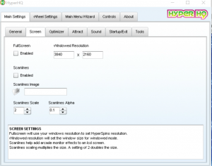

siccstepsccs Posted January 20, 2016 Posted January 20, 2016 Hyperspin is showing half screen when im in a game when my text size scaling is set too 150 on windows 10 the only way I can run hyperspin correctly is when i turn the text scaling to 100. I But then my task bar and everything else is really small. I tried changing the screen settings to 3840 x 2160 and 1920 x 1080 in HyperHQ still no go. Any ideas?
