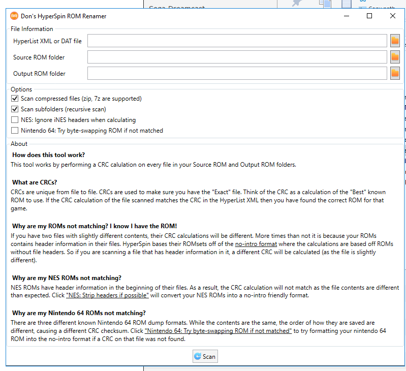

vaderag Posted February 12, 2016 Author Posted February 12, 2016 Okay, so been using TurMatcher for a while now and it's awesome. BUT, I need some help with something... Basically I have realised that by renaming the zip files of the roms, it obviously isn't changing the name of the file within the zip and this means that it can't load the game... Is there a tool out there that can bulk check/rename the contents of the zip to the same name as the zip?
vaderag Posted February 12, 2016 Author Posted February 12, 2016 So I tried that a while ago, but unless I missed something it required the CRCs to match (which half of mine don't...) Is there any way around that? I fixed the particular issue I was having by using winrar to convert to zip from 7z so that Snes9x can open natively as the contents don't need name match, but that wont work with systems with larger roms/sets as I'll lose too much space
vaderag Posted February 12, 2016 Author Posted February 12, 2016 There's a checkbox to disable CRC matching and use fuzzy matching instead. Awesome - i must have totally missed that... I'll check it out again this eve
vaderag Posted February 12, 2016 Author Posted February 12, 2016 Okay, so I don't have that checkbox at all... Just redownloaded to make sure I wasnt using an old version, but nope - i dont have it...
vaderag Posted February 12, 2016 Author Posted February 12, 2016 Turns out that is an old version (despite being way more obvious on the site) Here is the final version... http://www.hyperspin-fe.com/files/file/11125-dons-hyperspin-tools-43-beta-significant-rom-renamer/
vaderag Posted February 12, 2016 Author Posted February 12, 2016 Yeah, the one in that link is the one I use. It's a revelation! The version I was using must be 5 versions out of date or something!! Should delete it from the site, it's useless next to this version!!

Turranius Posted March 8, 2016 Posted March 8, 2016 Old response to the "while Tur-Matcher renames the .zip files, it does not rename the files inside" question. I usually only rename a set once so I never built any "rename files inside .zip" function into Tur-Matcher. I simply just... Extract all zip files to a new folder Run the match with Tur-Matcher on the extracted files Select all renamed files Right click. Winrar / Add to Archive Select Archive Format: ZIP Files tab, check "Put each file into seperate archive" OK You now have the set renamed. .zip file is called the same as the rom file inside it. Mame related stuff: FTP: grandis.nu, port 21, user:misc, pass:misc http://grandis.nu/software Tur-Matcher - Match your roms/media/XML files. Another Idle Volume Adjuster - Automatically control the volume. How to: Use MAME Extras as material for HyperPause How to: Use eXoDOS 2.0 as material for HyperPause
