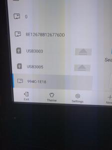

badhemi Posted February 23, 2016 Posted February 23, 2016 I can't record either this is bullcrap. When I insert hard drive in usb port I have the usb labled as USB3002 and it has hyperspin folder then when I click on that it has all my files. Then I have sd card LABELED F474B7AA74B76DCC AND IT HAS ALL MY HYPERSPIN DATA THEIR TOO WHAT THE HECK!!!! When I record it says android database insertion failure

badhemi Posted February 23, 2016 Posted February 23, 2016 The usb number keeps changing. To I use sd card number?
badhemi Posted February 23, 2016 Posted February 23, 2016 I got it it's the long a$$ number before you mount usb. What a pain to have to change all those numbers. Why can't you record anymore? Is it a bug
reznnate Posted February 23, 2016 Posted February 23, 2016 Badhemi -- this path /storage/usbdrive/ is no longer valid on M. It only worked on L. If you have Shield Android TV, use ES File Explorer to determine your drive's UDID value. THEN, /storage/<udid value> should work for you. If you have a tablet, you must use internal storage or ext-sdcard (again, use es file explorer to determine the udid). NVIDIA needs to post an update that adds a (/storage/) mount point for the usbdrive file system.

badhemi Posted February 23, 2016 Posted February 23, 2016 Badhemi -- this path /storage/usbdrive/ is no longer valid on M. It only worked on L. If you have Shield Android TV, use ES File Explorer to determine your drive's UDID value. THEN, /storage/<udid value> should work for you. If you have a tablet, you must use internal storage or ext-sdcard (again, use es file explorer to determine the udid). NVIDIA needs to post an update that adds a (/storage/) mount point for the usbdrive file system. have nvidia tv. Thanks got it rez
