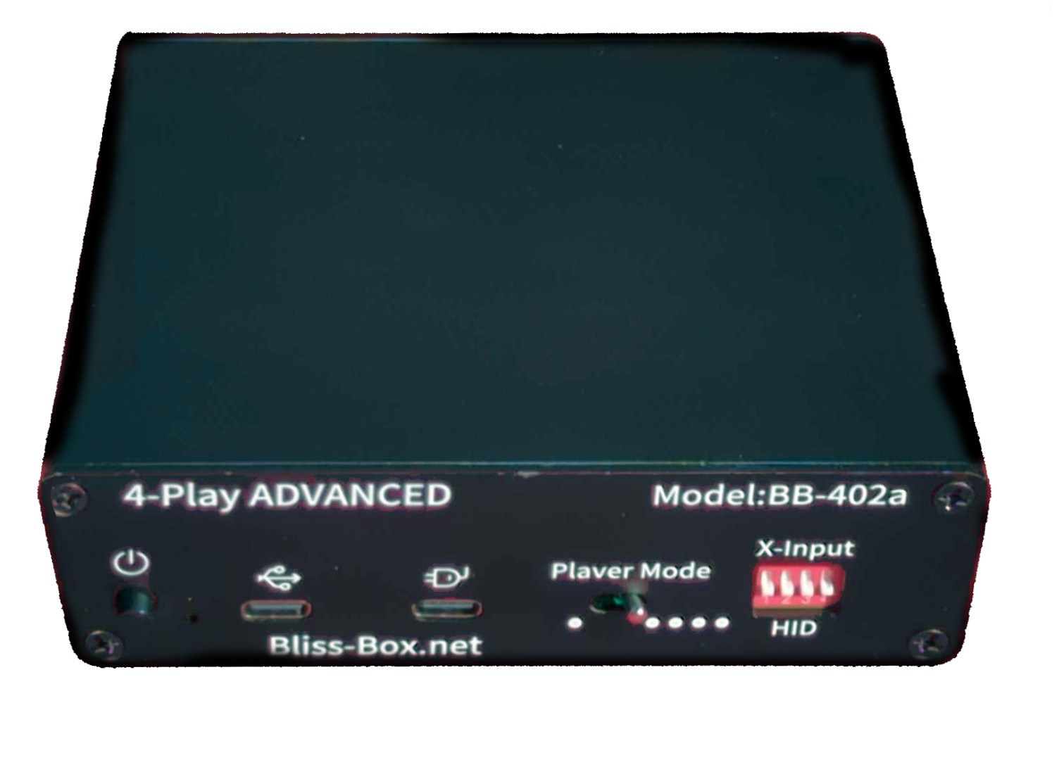

newoski Posted May 19, 2017 Share Posted May 19, 2017 Also, after flashing the custom firmware successfully and experimenting for the last 24 hours, my Port1 just completely disappeared. WTF. Reflashing, following the instructions (press button, plug USB, select firmware and hold til complete) isn't working at all, to reflash that port Link to comment Share on other sites More sharing options...
iNTiGOD Posted May 19, 2017 Share Posted May 19, 2017 Have you tried plugging the blissbox into a different USB port and reflashing?Re my setup, I'll get back to you over the weekend and update in this thread. My setup hasn't been touched in a while so I can't remember which version of retroarch I'm using. Link to comment Share on other sites More sharing options...

newoski Posted May 19, 2017 Share Posted May 19, 2017 Also, after flashing the custom firmware successfully and experimenting for the last 24 hours, my Port1 just completely disappeared. WTF. Reflashing, following the instructions (press button, plug USB, select firmware and ho 5 minutes ago, ulao said: Did all 4 ports before you used the 4-play fix? They worked before, and after. Then, the next day, the Port1 disappeared Link to comment Share on other sites More sharing options...
newoski Posted May 19, 2017 Share Posted May 19, 2017 I have tried using the jumper method, to fix the issue, as well. No progress... Link to comment Share on other sites More sharing options...
