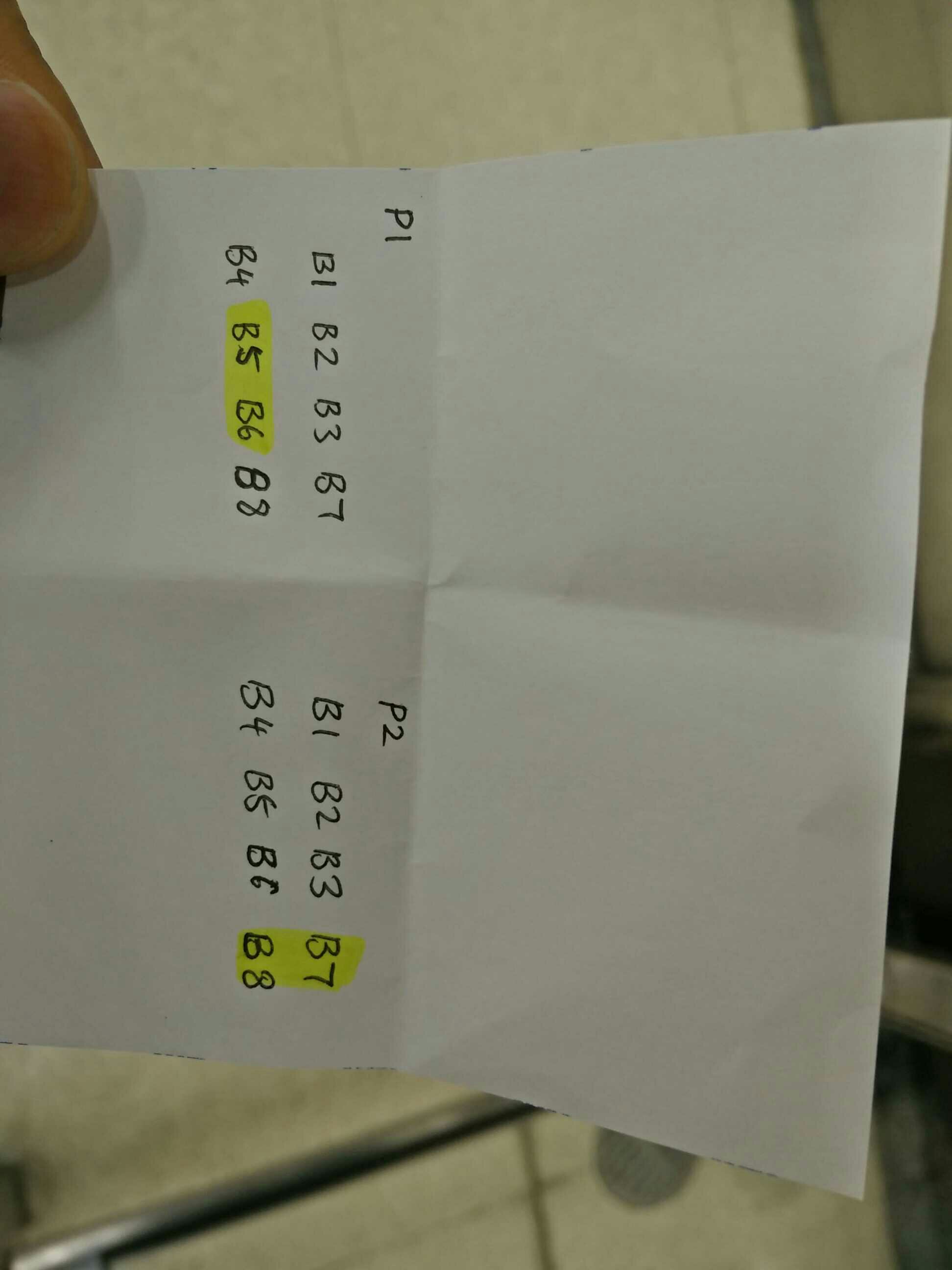

shitoken Posted June 7, 2016 Posted June 7, 2016 Hi sevenseal bro, Thank you for helping this morning during your hard time. Appreciate. I have done a drawing of my panel the highlighted 2 buttons in P1 & P2 still lit up whenever in a main theme of system. Tapatalk を使用して私の A0001 から送信
sevenseal Posted June 11, 2016 Posted June 11, 2016 Hi sevenseal bro, Thank you for helping this morning during your hard time. Appreciate. I have done a drawing of my panel the highlighted 2 buttons in P1 & P2 still lit up whenever in a main theme of system. Tapatalk を使用して私の A0001 から送信 i would try to disable light up frontend buttons... that might be causing problems
shitoken Posted June 11, 2016 Posted June 11, 2016 Thanks Bro, But this will be a temporarily solution because if arzoo added this option in GUI means we can use it and should not be any problem unless others reported with a bug in this. Now I am launching direct from RL but have this problem too sometime. God knows what's is wrong haha Tapatalk を使用して私の A0001 から送信
sevenseal Posted June 11, 2016 Posted June 11, 2016 Thanks Bro, But this will be a temporarily solution because if arzoo added this option in GUI means we can use it and should not be any problem unless others reported with a bug in this. Now I am launching direct from RL but have this problem too sometime. God knows what's is wrong haha Tapatalk を使用して私の A0001 から送信 the reason why i suggested it because the frontend buttons are not setup in ledblinky, colors and keys assignment are not done.. rocketblinky doesnt setup that part either... just so you are aware
shitoken Posted June 11, 2016 Posted June 11, 2016 the reason why i suggested it because the frontend buttons are not setup in ledblinky, colors and keys assignment are not done.. rocketblinky doesnt setup that part either... just so you are awareOK I will try to disable and try again later today before go bedTapatalk を使用して私の A0001 から送信

shitoken Posted June 14, 2016 Posted June 14, 2016 Newoski and Sevenseal Thank you so much bro, without you I will not success. Finally I have solved the lighting problems after setting the following Define either a FE Active Animation within LEDBlinkyConfig.exe or add your preferred Colors to the HyperSpin Front-End Controls layout To define a FE Active Animation, run LEDBlinkyConfig.exe, click on the FE Options tab, and choose an FE Active Animation from the dropdown. Next I will try to learn and set the lights for other systems under MAME such as capcom , zinc ,etc.
