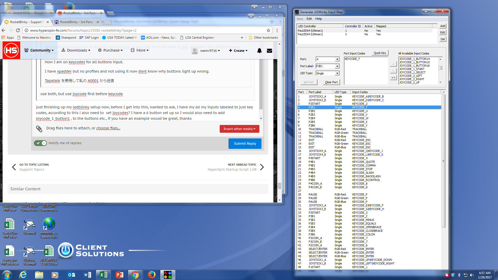

wemr97dl Posted January 29, 2017 Posted January 29, 2017 On 5/29/2016 at 9:52 AM, sevenseal said: On 5/28/2016 at 2:23 AM, shitoken said: Iedblinkyinput file I have set all the buttons with RGB per buttons and single led. One thing confusing me is should I use joycode or keycode if my encoder is ipac ultimate with default mame setting? Now I am on keycodes for all buttons input. I have xpadder but no profiles and not using it now dont know why buttons light up wrong. Tapatalk を使用して私の A0001 から送信 use both, but use joycode first before keycode Just getting ledblinky started now and planned on using rocketblinky for hyperspin, I only mapped keycodes, accourding to this I would need to go bake and add all the matching joycodes?? so for p1start I would need my keycode and joycode_1_START, and for admin would I do anything? also seen somewhere reading about there being a problem with using P for pause?? heres a quick pic of what I have so you can see it
newoski Posted January 29, 2017 Author Posted January 29, 2017 Just getting ledblinky started now and planned on using rocketblinky for hyperspin, I only mapped keycodes, accourding to this I would need to go bake and add all the matching joycodes?? so for p1start I would need my keycode and joycode_1_START, and for admin would I do anything? also seen somewhere reading about there being a problem with using P for pause?? heres a quick pic of what I have so you can see it Wait until you are ready to actually test. At that post point, I can log in and help. It would be really confusing, without controls to test. If you plan to use keyboard and joycodes, it's probably best to nap to keycodes in Rocket blinkySent from my HTC6535LVW using Tapatalk
wemr97dl Posted January 30, 2017 Posted January 30, 2017 Wait until you are ready to actually test. At that post point, I can log in and help. It would be really confusing, without controls to test. If you plan to use keyboard and joycodes, it's probably best to nap to keycodes in Rocket blinkySent from my HTC6535LVW using TapatalkOk thanks I'll be ready soon so far everything in ledblinky is working Sent from my iPhone using Tapatalk
newoski Posted January 30, 2017 Author Posted January 30, 2017 Ok thanks I'll be ready soon so far everything in ledblinky is working Sent from my iPhone using TapatalkYou just need to make sure your MAME inputs match whatever you map in Rocket Binky. I'll explain via TeamViewer when you're readySent from my HTC6535LVW using Tapatalk
