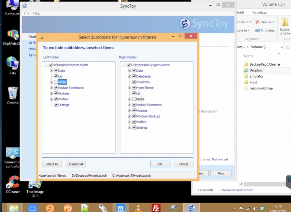

Ok find a best solution...the name it's SyncToy and it's a windows certificated software (downloadable under Windows website)
- download dropbox software and link a new folder
- "upload from my dropbox" to RL dropbox folder (wait local folder download)
- after you download the folder link whit SyncToy and decide what files/folder you can sync (a lot of filter available, you create a work-batch), after press RUN
NB you can see a preview before overwrite or create new files!
just be carefull to not overwrite any ini files because they have your settings, on both Modules and settings folders.

Yes this it's the right question...i've localized the right folder but i've dubt about extension...
In this software it's possible exclude some extension...now i've removed the ini files from all folders!
Very powerful but need right settings!
Other extension to remove?

This method it's good if:
- you do not want search around the forum the last 3d of updating
- you do not want update daily the Hyperlaunch folder (but one times at week for example)
- 2 click for update (sync to my dropbox, SyncToy)
the only cont are:
- right setting of the overwrite parameters (the *.ini, don't be updated, and if you know other file extension)
- preview button before overwrite in SYNCTOY (the first time)
Request from Djvj:
If you want try this update system and create a personalized settings with SyncToy , for the folder and extension who doesn't need update; i think it's the best automated update system for the moment...
