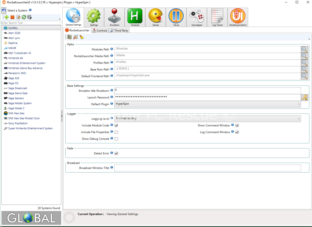

open RocketlauncherUI
Click on the Global Tab
Click the Generla Settings Tab
Find the Logger Section
Make sure the troubleshooting is selected from the drop down menu
once you have everything up and running you can change your Log view to off,  as a command line window will pop up when you have your log set to troubleshoot.
and all your settings seem to be correct can you, not sure what your problem is.
Can you post a picture of your RocketauncherUI screen that shows the Log level set to Troubleshoot.  I like to confirm 2 other paths.

I will start the logging now and post it along with screenshots :)

Image age as requested
http://www.mobilepcrescue.co.uk/wp-content/uploads/2016/04/hyperspin05.png
Thanks for all your help :)
Your HS log shows that you are indeed using RocketLauncher now, so that's properly configured. Is everything working properly now or are you having issues?
Hi mate, it all looks like its working, as it was the other night, maybe if I had posted the right log, we may have seen it was actually running ok lol
I will try it properly tomorrow evening when I have more time :)
Thanks again to everyone who has helped resolve this :)
Steve
