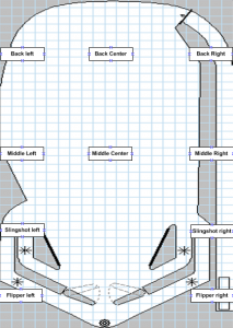

arngrim Posted August 1, 2013 Posted August 1, 2013 Here's some exclusive: The anticipated and in test new framework (in development in VPUniverse), that will replace ledcontrol.vbs in mid term allows you to use more than one ledwiz, up to 16 in fact We have defined in the dev ledwiz configtool the ability to use up to 6 ledwiz with the website configurations, and I have two ledwiz installed on my cab. One use the virtual output kit and the second one is connected to a bare bones booster from Zeb too. This is just one of the advantages of the new framework, we will announce the tool for beta newt month or in two months if we feel ready, new configurations for all the tables are in preparation for the new possibilities of this new tool A big fundamental difference with the current configuration available, we have defined the 10 contactor setup according to this schema attached, there was a hole between the bumper contactors and the slingshots, it is much more according to the reality like this. And all tables will have their 8 and 10 contactor setup
neohusky Posted August 1, 2013 Posted August 1, 2013 I had read up a little on the DOF but wasn't sure how far along it was. It's AWESOME knowing its only around the corner. Im also glad to hear I wouldn't need much more to get extra toys. Another LEDwiz and bare bones booster. To know, is to know that you know nothing. That is the meaning of true knowledge.
