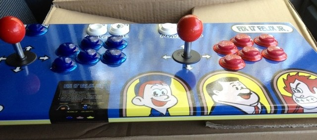

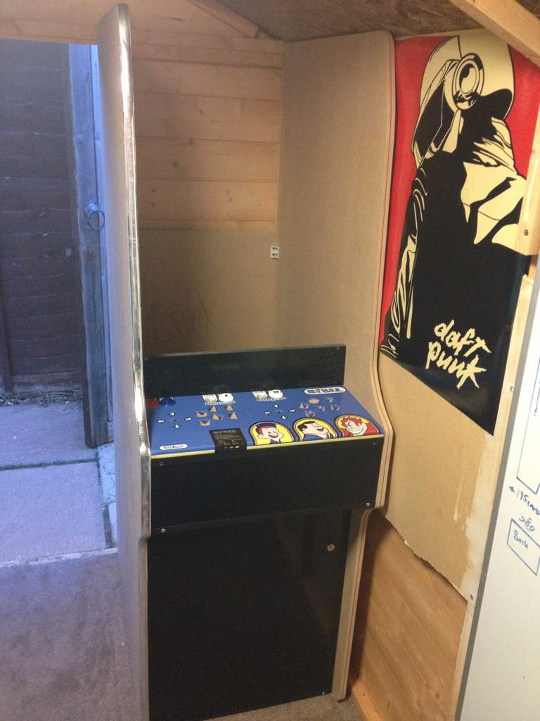

monkeychunkuk Posted August 28, 2013 Posted August 28, 2013 Cool nice Theme.Further so @ monkeychunkuk Nice Site escpecially the Tron Cab ,-) Greetings uNkeLo Cheers mate ; ) I'm looking forward to seeing what angle you put your screen I have a donkey kong/fix it felix build and I'm not sure how to locate the monitor
MontyQ Posted August 28, 2013 Author Posted August 28, 2013 For the angle of the screen all I did was measure the distance of my two 2x4 boards inside my real dk3 cab, then I measured the distand from the inside floor to the bottome of the 2x4, then fram the back edge to inside after that I knew where it went. As for the angle I just traced the angle on a flush page of paper and redrew it where I wanted my boards to be....so far so good. If when I'm done and you like the look of how it sits then I can remeasure and tell you.
monkeychunkuk Posted August 28, 2013 Posted August 28, 2013 Thanks buddy that would be great I'm still not Sold on seeing screen through a bezel I'm not used to it with only playing on my versions No rush with the measurements I have lots to do before I fit the monitor ; )

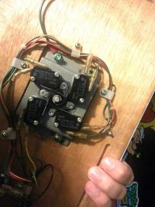

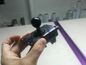

RidicRick Posted August 28, 2013 Posted August 28, 2013 Well.. got a call from my lawyer (got child/ex issues) and I didnt make it back in time to get your package out yesterday. But.. good news is its going out right now, Ill have tracking number for you shortly. AND I threw in a complete Nintendo joystick for ya in case you decided to make it more original. I didnt want to see a zippy in there. Here she is.. you just need to clean her up. You will have to route out a section under the control panel just like the real popeye because its a short shaft version. This way it will still barely stick out just like the orignal Popeye.
MontyQ Posted August 28, 2013 Author Posted August 28, 2013 Well.. got a call my my lawyer (got child/ex issues) and I didnt make it back in time to get your package out yesterday. But.. good news is its going out right now, Ill have tracking number for you shortly. AND I threw in a complete Nintendo joystick for ya in case you decided to make it more original. I didnt want to see a zippy in there. Here she is.. you just need to clean her up. You will have to route out a section under the control panel just like the real popeye because its a short shaft version. This way it will still barely stick out just like the orignal Popeye. [ATTACH=CONFIG]31309[/ATTACH] Wow Rick I thank you kindly, this is huge news It is extremely kind of you and I thank you many times over to you BTW ever in Canada come on over for beers Rick popeye is 8-way right? Do I need to get a 8-way restrictor plate for that stick ?
RidicRick Posted August 28, 2013 Posted August 28, 2013 No problem man, I have about 4 or 5 of those laying around so I figured one of them can go to a good home. I need to keep the rest for my projects. Now, it has a 8-way guide plate. You will eventually need a 4-way guide plate found HERE unless you plan on having the cab play other games that can use 8-way. That being said I know Popeye is hard to play with an 8-way..ive tried.. its a pain, but still playable. Also it would help to get a clear plexi joystick guard HERE. I have that backwards..not sure what i was thinking... its 8 way and popeye should be 8 way.. LOL... 4 way is hard to play..as you need to get up stairs and such..lol.. i need more sleep

RidicRick Posted August 28, 2013 Posted August 28, 2013 Awesome! good to hear! I always buy from Mikesarcade, one of my favorite places to shop, good guy. Also with that Nintendo controller you will not need that black plastic base part, just remove that and junk it as its for the red tent and VS cabs. Unless you can somehow fabricate a metal control panel and use it, then it makes the hole look much nicer under the joystick guard. But your best bet is remove the plastic piece, then figure out how far to route a section for the joystick base. It may be easier to just use 3/4" wood instead of 1/2", gives you more sturdyness when routing out a section really thin. Just some suggestions. Of course then that means 3/4" t-molding that wont match your 1/2" t-molding for the rest of the cab.

monkeychunkuk Posted August 29, 2013 Posted August 29, 2013 Wow thus build has taken a real professional realism turn,if you route out the back of the Cp for the Nintendo joysticks does it weaken it?
MontyQ Posted August 29, 2013 Author Posted August 29, 2013 ya it would weaken it abit, but then kids have been smashing dk in the arcade for decades and they keep going like the energizer bunny. Plus with the shorter chubby Nintendo sticks when playing its a lot harder to like full fist it into the floor, then again I take care of all my stuff and it's not like its in an arcade....just my entertainment room.
monkeychunkuk Posted August 29, 2013 Posted August 29, 2013 I've always you used Zippy but maybe my Fix it deserves the right joysticks?
MontyQ Posted August 29, 2013 Author Posted August 29, 2013 I find playing Nintendo games on a real stick a lot different then on any other stick. It's tiny its loose play action, and I always would think playing on my other machine with stiff happ sticks it would be better.....it's nothing the same. But being a fan of those games the real stick just feels great, not like you could say play SF2 with a Nintendo stick. So in the end certain games feel just right imo with the controls you grew up playing them on. Like playing Metal Slug on a real Neo Geo cab is awesome feel for me as it seemed growing up every pool hall /bar here had a Neo Geo cab to play. lol that and Golden Tee was also everywhere.
