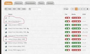

Gilrock Posted October 2, 2013 Posted October 2, 2013 I'd still like to know how to delete the items I circled in red:
freezy Posted October 2, 2013 Author Posted October 2, 2013 It's true that there's currently no easy way to delete an entry from the database, all you can do is enable/disable it in HyperPin. Will add this soon. Thanks for noticing HyperPin not working when not all tags are being written, I'll fix that too. As for tabs vs. spaces, Pind rewrites the XML when you add a new table to it, there's no real way around that. Note that if the HP icon is grey, that means it's commented in the XML (or deleted, depending on your setting).
