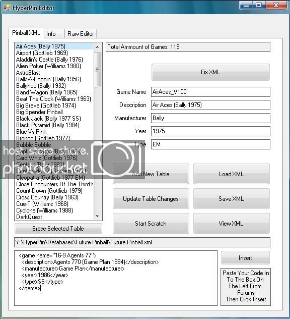

Ok i re written the code for this that now uses Full XML Editing Capabilities.
The code has been reduced for better compatability and uses only the bare minimum resources.

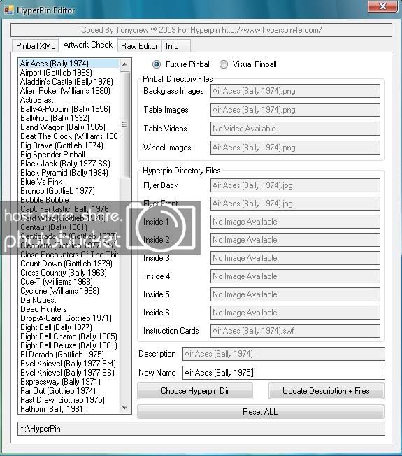

UPDATE ART Ok this feature will now RENAME your ART FILES just type in the New Name and it will update your artwork and your XML to match. (I've tried to put Error Catching in but don't rely on it you all know what PC's are like)
Features:-
Ok i just added an Artwork Check it will check if there is a problem with the artwork.. i.e. Missing art or if it is named incorrectly it will say "No Image Available" . It now also checks for Instruction Cards and Flyers. Works on Both Visual Pinball and Future Pinball XML Files.
Paste Code from these forums and it will insert and AUTO SORT into ALPHABETICAL ORDER.
AUTO Sorts NEW XML Loaded.
Formats XML Correctly.
Add New Table, Update Existing Table.
Fix XML option for XML that won't load.
2 Download options Any CPU should work on all Versions of Windows XP and Vista, But if you have a 64Bit OS and it won't work try the X64 Version. (Not tested as i don't have 64Bit OS)
Please report any bugs you may find...
Any CPU Version Download
http://files.filefront.com/Hyperpin+Editor32BitCrar/;13897233;/fileinfo.html
64Bit CPU Only Download
http://files.filefront.com/Hyperpin+Editor64BitCrar/;13897234;/fileinfo.html
Also Available on the FTP for those who can access...

Looking at my code... (i am new to this, as my son didn't do this one lol) but what i do is VERY VERY SIMPLE i create a dataset and read the XML to the dataset and also read all the xml to a textbox and pass the description to a listbox.
I also reset the Dataset just before passing the XML to it, so that the dataset is totaly clean everytime.
Dim ds1 As New DataSet
ds1.reset()
ds1.ReadXml(OpenFileDialog1.FileName)
       TextBox9.Text = My.Computer.FileSystem.ReadAllText(OpenFileDialog1.FileName)
then pass it to a listbox
[/code] With ListBox2
.DisplayMember = "description"
.DataSource = ds1.Tables("game")
End With[/code]
then create the display members from the datasource
Comboboxes are hidden.
With ComboBox1
           .DisplayMember = "name"
       End With
       With ComboBox2
       End With
       With ComboBox3
           .DisplayMember = "manufacturer"
       End With
       With ComboBox4
           .DisplayMember = "year"
       End With
       With ComboBox5
           .DisplayMember = "type"
       End With
       TextBox2.Text = "Total Ammount of Games: " & ComboBox1.Items.Count.ToString
       TextBox12.Text = OpenFileDialog1.FileName
Textbox 12 just holds the file path
Textbox 9 holds the <menu> tabs for me. (i know you may look and wonder why some stuff is in there... it's because when doing the hyperspin editor there were alot of problems with peoples xml's not being the same, ie no tabs or proper layout.
Edited by tonycrew
Tony: Just an FYI, when reading in XML, tabs should not matter. When writing XML with .NET, you can set the formatting of the output to auto-tab based upon how each element node is written.
I'm not an expert on VB.NET which it appears what yours is done in, but I at least know C / C#, and I currently use ArrayList<string>'s (not list boxes) to store my data temporarily (not the best way of doing it, but it works).
This is going to change very shortly as I rewrite my code to intertwine with Hyperion a lot more, however.
-Lashek
I invented HyperList! :)
http://hyperlist.hyperspin-fe.com
Please do not ask me support questions about HyperList, I am no longer a part of the team/project.
Thanks... i know my coding is a bit... caveman like (hehe) i do seem to do thing a bit longwinded sometimes.... But i always try to keep it a basic as possible. I know we used string arrays on the last one at certain points.
I'm gonna put some new code in to try to get the & fixed before passing it to the dataset.
I just edit the xml file with notepad
We know that but some people asked about an XML editor for this so i made one.
Thanks Tonycrew. Notepad is an option but I thought some people my have issues with managing their databases and in some cases using a database editor is much quicker. I say put it out there and let the user decide. At least it's available. Good work!
Nice, now that part is actually a time saving feature. I hate finding where to insert a game, I know its easy but it annoys me. Inserting the code into that part saves me time by not having to locate the right spot for the game and not having to add in the formatting either. When I paste the text into notepad it loses the formating also, since the forum post loses formatting. Thanks toneycrew.
No Worries.. please remeber i am still working on this.. so it's a work in progress and things may need to be altered in the code. As people use this program and sometimes get different results.... And i only been doin VB for a couple of weeks as before it was my son... so i am still learning myself.
What i am doing at the moment is coding a formating part that makes sure everyting is correct as you load your XML cause some people mess theirs up abit.
