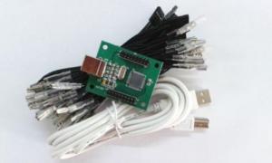

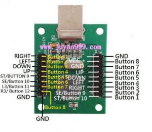

jrose1184 Posted November 19, 2013 Posted November 19, 2013 Hello i have bought a xin mo arcade pad. i have configured it to all my emulators and works great. However i can not connect it to hyperspin to use for selecting games or exiting!!!. i have have gone onto hyperhq and configured it under the control tab and still dont work.... please help
relic Posted November 19, 2013 Posted November 19, 2013 you need to set it in global and make a hyperspin hyperlaunch and default profile in hyper launch hq or just start xpadder as a start up app with hyperspin in hyper hq 100%

Peja Posted November 19, 2013 Posted November 19, 2013 With my joysticks, I needed to use xpadder in order to navigate within Hyperspin. I also had to enable ghutch's HS Startup.exe within HyperspinHQ. This got my joysticks and navigating to work. Peja
gigapig Posted November 19, 2013 Posted November 19, 2013 With my joysticks, I needed to use xpadder in order to navigate within Hyperspin. I also had to enable ghutch's HS Startup.exe within HyperspinHQ.This got my joysticks and navigating to work. Peja Very true, if it shows up as a gamepad in windows then it may not work with newer versions of Hyperspin. You will need to use xpadder or joytokey.
ghutch92 Posted November 19, 2013 Posted November 19, 2013 This should help get you started with xpadder and RL. https://sites.google.com/site/hyperlaunch2/home/features/keymapper For any questions about xpadder, you'll get better answers on the xpadder forums. How to Install HyperSpin and more RocketLauncher HyperSpin Startup Script
jrose1184 Posted November 20, 2013 Author Posted November 20, 2013 Hi thanks I have done that no I have a list of all 3 names what do I do next please
