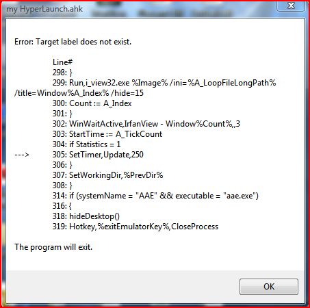

Hi Guys. First post here, if I remember correctly. I have had a couple of requests to Add support for Marquee Magician to HyperSpin. For those of you who don't know, Marquee Magician is a program that displays Game \ Emulator Specific graphics on a secondary monitor. You can read about it here:
http://www.gameex.info/forums/index.php?showtopic=6911
This is the code that I came up with for HyperLaunch:

I keep getting this error "attached thumbnail".
I'm looking for Target Label, "settimer", and only see it at the error line section 2 and in section 3 but i dont think the script gets down that far.
Do I need to define this "settimer" target label in the script somewhere or is there a syntax error?
Using the exact script posted in post #1
Copying from 3 sections similar to betabrites' setup.

[color=red]SetTimer, Update, Off[/color]
Ok, I missed a section to put in my code. There are actually 4 different sections.
So that nobody else screws up like me, I've highlighted the sections to add into your ahk.
The error above is now gone and now i have a new message when I launch mame through Hyperspin. see attachment

[color=lime];*************************************** Marquee Magician ******************************************[/color]
[color=lime];****************************** Added by Matt Mclemore AKA Tempest *********************************[/color]
[color=lime];*********** Marquee Magician will display game specific graphics on a secondary monitor ***********[/color]
[color=lime];************ For support, see: http://www.gameex.info/forums/index.php?showtopic=6911 *************[/color]
[color=lime]if (EnableMarqueeMagician)[/color]
[color=lime]{[/color]
[color=lime]PrevDir := A_WorkingDir[/color]
[color=lime]SetWorkingDir, %MarqueeMagician%[/color]
[color=lime]IfNotExist, MM.ini[/color]
[color=lime]MsgBox, You need to run the setup program first.[/color]
[color=lime]Goto ExitScript[/color]
[color=lime]}[/color]
[color=lime]Run, i_view32.exe /killmesoftly[/color]
[color=lime]IniRead, TimesPlayed, MM.ini, %systemName%, %romName%, 0[/color]
[color=lime]TimesPlayed++[/color]
[color=lime]IniWrite, %TimesPlayed%, MM.ini, %systemName%, %romName%[/color]
[color=lime]IniRead, Template, MM.ini, %systemName%, Template[/color]
[color=lime]If Template <> Error[/color]
[color=lime]IniRead, Type, MM.ini, General, Type[/color]
[color=lime]StringSplit, Filetype, Type ,|[/color]
[color=lime]SetFormat, float, 0.0[/color]
[color=lime]EnvGet, NumCpu, NUMBER_OF_PROCESSORS[/color]
[color=lime]VarSetCapacity(Idletime,8,0)[/color]
[color=lime]WinWaitClose, IrfanView ;*** Wait Or kill the following ***[/color]
[color=lime]Statistics = 0[/color]
[color=lime]TemplateFolder = Templates\%Template%[/color]
[color=lime]Loop, %TemplateFolder%\*, 2[/color]
[color=lime]IniRead, FileFolder, MM.ini, %systemName%, FileFolder%A_Index%[/color]
[color=lime]IniRead, Image, MM.ini, %systemName%, Image%A_Index%[/color]
[color=lime]If FileFolder = 4[/color]
[color=lime]Statistics = 1[/color]
[color=lime]IniRead, X, %A_LoopFileLongPath%\i_view32.ini, WinPosition, XKoord[/color]
[color=lime]IniRead, Y, %A_LoopFileLongPath%\i_view32.ini, WinPosition, YKoord[/color]
[color=lime]IniRead, W, %A_LoopFileLongPath%\i_view32.ini, WinPosition, Width[/color]
[color=lime]IniRead, H, %A_LoopFileLongPath%\i_view32.ini, WinPosition, Height[/color]
[color=lime]Loop, 7[/color]
[color=lime]IniRead, Stats%A_Index%, MM.ini, %systemName%, Stats%A_Index%[/color]
[color=lime]Gui, 6:default[/color]
[color=lime]Gui, -Caption[/color]
[color=lime]Gui, Font, s14[/color]
[color=lime]If Stats1 = 1[/color]
[color=lime]Gui, Add, Text, w300 h20, %systemName%[/color]
[color=lime]If Stats2 = 1[/color]
[color=lime]Gui, Add, Text, w300 h20, %romName%[/color]
[color=lime]If Stats3 = 1[/color]
[color=lime]Gui, Add, Text, w250 h20, TimesPlayed: %TimesPlayed%[/color]
[color=lime]; If Stats4 = 1 ; FPS not available in HS[/color]
[color=lime]; Continue[/color]
[color=lime]If Stats5 = 1[/color]
[color=lime]Gui, Add, Text, w250 h20 vPlayTimerText, Play Timer: %PlayTimer%[/color]
[color=lime]If Stats6 = 1[/color]
[color=lime]Gui, Add, Text, vCpuText, CPU Usage: 00`%[/color]
[color=lime]Gui, Add, Progress, w250 h20 50 vCpuProgress[/color]
[color=lime]If Stats7 = 1[/color]
[color=lime]Gui, Add, Text, vMemText, Memory Usage: 00`%[/color]
[color=lime]Gui, Add, Progress, w250 h20 vMemProgress[/color]
[color=lime]Gui, Show, x%X% y%Y% h%H% w%W%[/color]
[color=lime]Continue[/color]
[color=lime]IF FileFolder = 2[/color]
[color=lime]IniRead, Backup, MM.ini, %systemName%, Backup%A_Index%[/color]
[color=lime]Found = 0[/color]
[color=lime]Image .= "\" . romName[/color]
[color=lime]Loop, %FileType0%[/color]
[color=lime]Temp := Image . FileType%A_Index%[/color]
[color=lime]IfExist, %Temp%[/color]
[color=lime]Image := Temp[/color]
[color=lime]Found = 1[/color]
[color=lime]Break[/color]
[color=lime]If Found = 0[/color]
[color=lime]Image := BackUp[/color]
[color=lime]Run, i_view32.exe %Image% /ini=%A_LoopFileLongPath% /title=Window%A_Index% /hide=15[/color]
[color=lime]Count := A_Index[/color]
[color=lime]WinWaitActive, IrfanView - Window%Count%,, 3[/color]
[color=lime]StartTime := A_TickCount[/color]
[color=lime]If Statistics = 1[/color]
[color=lime]SetTimer, Update, 250[/color]
[color=lime]SetWorkingDir, %PrevDir%[/color]

So Far this is working in GameEX only! (still waiting for a HyperSpin setup program, directory structure for gamelist should be different in the mm.ini below)
3 images full vertical height, equally spaced horizontally on secondary monitor 7" (Baby steps for me!)
G:\HyperSpin\MarQuee Magician\Templates\Template\Image1\i_view32.ini
I cant stretch the windows as seen in the video (the way I want it) manually or through setup.

Also maybe this:
"Gamelist=C:\Program Files\GameEx\DATA\gamelist.txt"
changes to somthing like this?:
"Gamelist=g:\hyperspin\databases\mame\mame.xml"
Not sure about "Daphne" for use in hyperspin.
Hey Chillinwater,
I had similar issues with newer releases of MM. I am still just using the first one he custom made for HS. The newer ones seem to be made for GameEx only. You may want to IM Tempest (probably would find him visiting GameEx forums more) and ask him if it would be possible to try the newer releases in a more HS friendly version. I had been testing some for him with it all but my time has been limited of late. I will soon be having surgery at the Mayo clinic that will incapacitate me for a few weeks on the 19th. I hope to finish the comic book stuff and make video of some of my up-till-now cab stuff and pics before then, won't be able to play or mess with it much for a short while after that. I had everything pretty much working like I wanted in the version of MM I had, the statistics did not display correctly, but I really didn't want stats displayed anyways. I know he mentioned in the newer version being able to have MM display a default image maybe with custom controls displayed when exiting emulators back to HS also, it may be something worth looking into...
Hope all goes well!.
Do you need someone to take care of your cab while your away?:flute:
Very cool by the way!
Yeah I pm'ed him yesterday but I think he is too busy on "CFG Magician"
Where is the first one he "Custom made" for Hyperspin? Is it posted somwhere? The couple I have seen always use the game list for GameEX in the mm.ini.
What does your MM.ini look like if you dont mind me asking?
How does it call Hyperspin gamelists?
I saw your post with VP and Marquee Magician also and as soon as I work this out, Id like to work on somthing like that. My screen is touch also.
