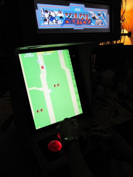

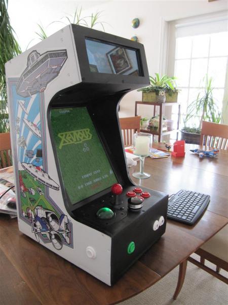

Xevious99 Posted March 26, 2013 Posted March 26, 2013 I decided to patch and compile my own mame with some marquee support in it for my attempt at making a arcade cabinet with a marquee. Running hyper-spin on the video card I used was just a bit too much for it. http://www.hyperspin-fe.com/forum/images/attach/jpg.gif http://www.hyperspin-fe.com/forum/images/attach/jpg.gif more info here http://www.xevious.site50.net/The%20Bartop%20Arcade%20Machine.html

kcorcoran Posted January 12, 2015 Posted January 12, 2015 I decided to patch and compile my own mame with some marquee support in it for my attempt at making a arcade cabinet with a marquee. Running hyper-spin on the video card I used was just a bit too much for it.http://www.hyperspin-fe.com/forum/images/attach/jpg.gif http://www.hyperspin-fe.com/forum/images/attach/jpg.gif more info here http://www.xevious.site50.net/The%20Bartop%20Arcade%20Machine.html thats a cool cabinet!
