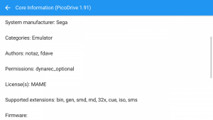

Sting Posted April 14, 2016 Posted April 14, 2016 Send me your settings file for Genesis, and I'll take a look. You must have a mistake in it or a space somewhere. I've just checked (Picodrive) and Genesis and neither are supposed to support (.zip), so I'd unzip a ROM and make sure the name matches the database (.xml), and remove all other ROM extensions from your (.ini) a part from the one your ROM is in.
