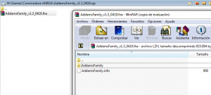

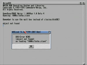

I've follow your tutorial and I have a question: Are the OS files needed to make the WHLoad to run? I' ve paid for a WHLoad key but everytime I try to run a game I get this error:
But, the .slave file exists:
I'm totally lost on this...

Hi,
The roms look right. That error is not because of the key. ;) It usually points to a bad rom or something like that. Maybe a HyperLaunch setting.
Be sure 7z is set to false and please post the following logs:
...\Emulators\WinUAELoader\Data\WinUAELoader.log
...\Emulators\WinUAE\winuaelog.txt
...\HyperLaunch\HyperLaunch.log
Please use code tags as described here: http://www.hyperspin-fe.com/forum/showthread.php?31072-The-HyperNoobie-Guide-For-Posting-To-The-Fourm
EDIT:
On further examination, I don't think WinUAE Loader can load lha files directly. WinUAE by its self can. You might try just using WinUAE. I have a guide in my signature for it.
Thanks,
Ron

Also, what is inside the zip file? Is it .info, .slave or is it .lha files?
Inside the zip file I have this:
Hope this helps...

Hi, im have a new problem.
later entry the officialy database and games WHDLOAD set new problem to set WinUAE config
at launch game with HyperlaunchHQ
this is the problem.
Im read and follow the tutorial
Sorry for my inglish.Not use transtlate
Regards

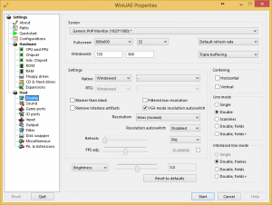

Launch WinUAE outside HLHQ.
Click Configurations on the left. Then hit the Load from... button.
Load your \Host\amigahost.uae file.
Then click Display on the left. Line Mode set to Scanlines.
Click Filter on the left.
Set the Filter Settings to Automatic Scaling
Click back on Configurations on the left.
Hit the Save as... button.
Save the config over your Host\amigahost.uae and test.
Thanks,
Ron

I get scanlines when it first boots then as soon as the WB screen comes up it is hi-res.

[ATTACH=CONFIG]50281[/ATTACH]
LOL.. You are spot on. Same here with WinUAE Loader. Scanlines to start and then none. Using just WinUAE and not WinUAE Loader works great. I have a guide for that emulator here: http://www.hyperspin-fe.com/forum/showthread.php?31472-Complete-Guide-for-Commodore-Amiga-in-HS-and-RL-Using-WinUAE-Only
The other option is to use a bezel with scanlines built in (or a fullscreen bezel with scanlines). ;)
