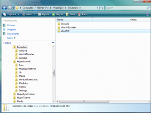

Download the correct version of WinVICE from the link above. Extract the contents of the zip file into your emulators directory. For this example we will use the following directory structure:
H:\HyperSpin\Emulators\WinVICE - The emulator directory.
H:\Roms\Commodore 64 - The directory I placed my game files in. They are in uncompressed format.

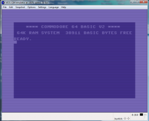

Let's run the file H:\HyperSpin\Emulators\WinVICE\x64.exe file for the first time and get the emulator setup.
If you have not run x64.exe yet, it will open in windowed mode. If you have run it before or it opens in full screen mode, just hit Alt + D to get to windowed mode:

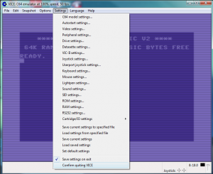

; Turn off the exit confirmation box by unchecking Settings->Confirm on exit
; Turn on saving settings by checking Settings->Save settings on exit, this will create the vice.ini file this module needs.
Click on Settings and check "Save settings on exit". Then again to Settings and uncheck "Confirm quiting VICE":

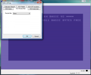

Now, let's adjust the video settings. This step is optional, I do not prefer to use scan lines.
Click on Settings again and click on "Video settings...". Click on the tab VICII Render filter and change the dropdown to None. Hit OK:

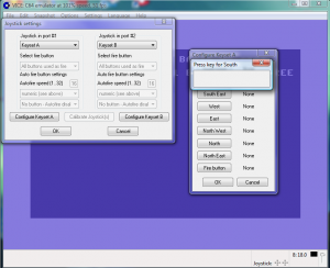

Now to setup your input settings. Click on Settings and click again on "Joystick settings...":
My setup, I used Joystick in port #1 set to Keyset A and port #2 to Keyset B and then mapped the appropriate keysets by clicking the "Configure Keyset A" button. When finished hit the OK button:

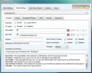

Launch HyperHQ and setup your new wheel using the Main Menu Wizard. Make sure you use the name "Commodore 64" so everything matches up.
Then click on the Wheel Settings tab and select Commodore 64 in the dropdown. Make sure the Emulator tab is selected. Set the following settings:
Execution: HyperLaunch
PC Game: Disabled
Rom Path: H:\Roms\Commodore 64\
Extensions: d64,t64,tap,crt,prg,nib (and any other extensions your roms may have)

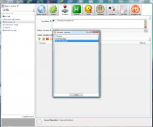

Bring up HyperLaunchHQ. Be sure GLOBAL is selected on the left and the Emulators tab on the top.
Scroll through the list of emulators to find WinVICE and double click. Click the magnifying glass on the right of Path and browse to H:\HyperSpin\Emulators\WinVICE and double click on x64.exe:
Close out the Edit WinVICE Emulator window by hitting the X in the top left corner.

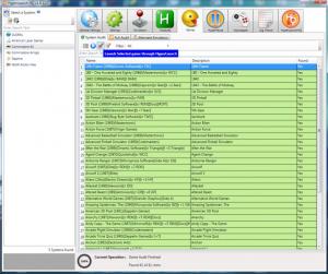

Next, select the Games tab on the top and audit the system by hitting the round blue play button. This should find all the games you have. Select one and hit the Launch Selected game through HyperLaunch:
If the game launches correctly. You are done!

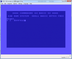

Also here's a screen shot of the C64 screen after I have pressed the buttons on the controller. The first 4 are the D pad, the rest are the buttons, which seem to be OK. The D pad was tested with cursor keys and WASD.

Yes, I think keymapping is the only way. With any computer emulator, each game may use different keys to start the game and to play it. And many use keys during the game. One of my favorites is Airborne Ranger. So, even with my cab, I keep a wireless keyboard close. But you can map the common ones. Run/Stop, Enter, Space etc... The rest will have to be done on a case by case basis.
The default layout in WinVICE for the 64 is Symbolic. Meaning, your keyboard layout is as close to the same as it can be: ftp://8bitfiles.net/cbm8bits/c128/emulators/WinVICE-2.1/html/vice_2.html#SEC12
Or you can use Positional. That lays out the keyboard like the C64: http://i16.photobucket.com/albums/b47/mmilken/c64keyboard.gif
In your ...Emulators\WinVICE\C64 directory are the keyboard maps. win_pos.vkm is the Positional mapping. The file win_sym_us.vkm is the US Symbolic mapping. Those files will tell you what keys are mapped to what on the emulator side.

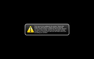

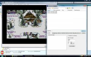

hello multigame not working, any solution?
22:18:57:078 | HL |     INFO  | +N/A   | Main - HyperLaunch v3.0.1.1c

22:21:06:065 | MD |     INFO  | +62    | WinWait - Waiting for "Attach disk image ahk_class #32770"
22:21:52:711 | MD |    ERROR  | +46644 | There was an error waiting for the window "Attach disk image ahk_class #32770". Please check you have the correct version emulator installed for this module, followed any notes in the module, and have this emulator working outside your Frontend first. Also turn off Fade to see if you are hiding your problem.

All i get is a blank purple screen. Both in winvice and ccs64. Any clue?
Please post your HyperLaunch log using Code tags as described here:
http://www.hyperspin-fe.com/forum/showthread.php?31072-The-HyperNoobie-Guide-For-Posting-To-The-Fourm
Thanks,
Ron
